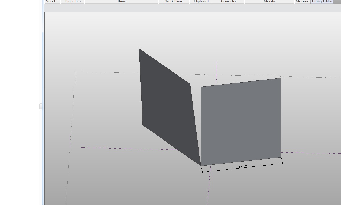

Hi, I am using Revit 2014
I am modeling something organic using the conceptual mass . I made two masses and i need to connect them together . the attached picture is showing an example of what i need , I cant send my real model because its confidential.
So my question is how can i connect or attach the two edges ??
* I know in this case (the one in the sent picture) i can delete on of the planes and extrude the edge itself ,BUT in my case i have two complicated models that i need to connect together.
Thank you ,

Why is it 2 different masses? Just create it as 1

they are 2 complicated masses i cant create them as one from the start

and i already spent alot of effort doing them

You can't join them if they are two different masses like you are trying to do.

Create just a portion of the other mass in each model so that the face in that model will be correct.  Then you don't need to join.
