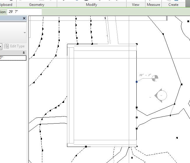

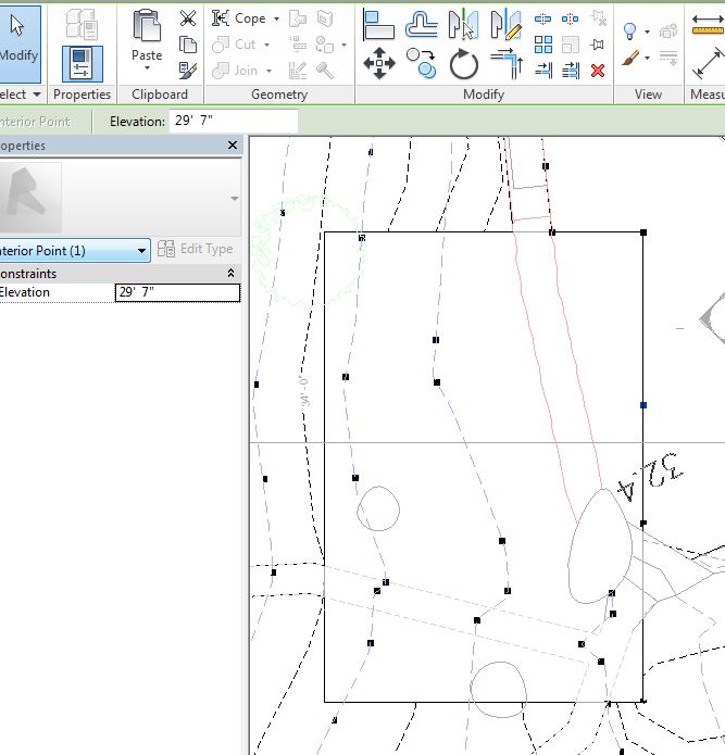

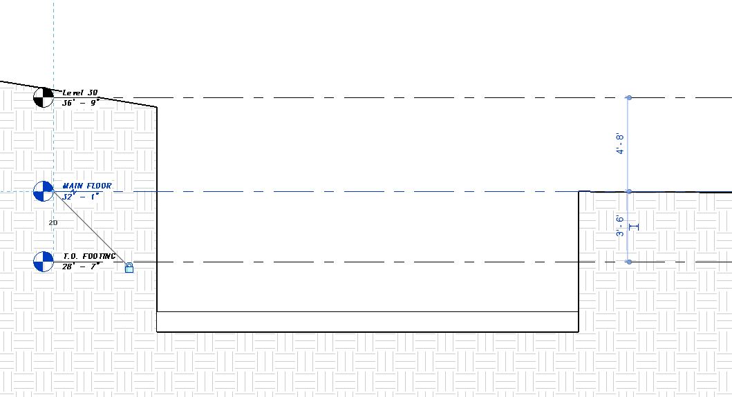

I'm using Revit 2014.  I imported my topo from a CAD file.  It is 2'6" off where it is supposed to be when compared to the site plan.  What's really strange is that if I look at it in the site plan view it is 2'-6" off, but when I go to the Section, it is not off.  For example, in the site plan a point at the front of my building pad is 29'-7", but when I go into the section this same point is now 32'-1" according to the level.  Does this have something to do with project level vs survey level - and how can I reconcile this?  I've attached a snap of it in sp and section for refernce.

why do you compare 2 different elements
on your site plan, you have selected a topo point. elev 29'7"
on your section, the one selected a level MAIN FLOOR 32'1"

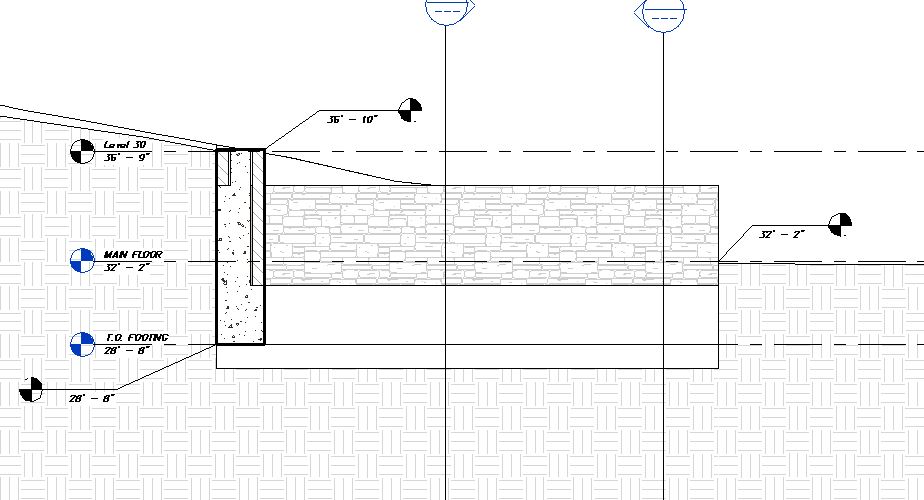

@WWHub.  I'll watch the video but in the meantime wanted to answer your questions.  Yes I created a topo from A CAD file. a CAD survey done by an engineer.  Attached here is the section and site plan with spot elevations.  You can see on the site plan where it says that that the blue highlighted topo point is 29' 7" but the spot elevation says 32'-1"   This shows the discrepancy I'm having trouble with.
Tue, Dec 17, 2013 at 12:19:06 PM | level elevation doesn't match elev point in topo / site plan
The section spot elevation is on the level line, not the topo.  In addition, you don't say what the reference is for your spot.
Turn off the levels, if the spot goes away, then it was to the level.  Now place a spot to the topo .... and show us your spot settings.

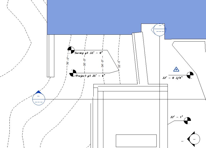

@WWHub - The video you recommended was very helpful, I feel like I have a better understanding of project vs. survey coordinates but I still can't figure out how to solve my problem.  See attached.  I have made 2 spot elevations - one from the Survey pt and one from the Project point as indicated. Note that they are the same because the survey and project point are aligned in elevation.  However, my topo map - contour labels shown here read 2'-6" lower than both my survey and project point.  Do you know how I can fix this?  If I move the whole topography - it will not be accurate in my section.

@WWHub - I found this info in this forum that sort of solved my problem :
"Create a sea level elevation and set it the correct distance below the first floor level. Select the site label contours - inside the type properties set to relative. Now, in the instance properties box under "other" the Relative Base dialogue should be active- set this to the sea level elevation you made. All your site contour labels should now change."
Now my contour labels come out correctly related to the spot elevations and sections, but when I go into the topo to edit the surface, the points are still 2.5' below what the contour label and spot elevations read.  Any ideas?

Did you set your project point and your survey point at the same place in elevation view?  I don't think you have.  Pay attention to that process in the video.

Yes, I have since done that - so that the survey and project spot elevations are the same (sorry the image I sent earlier they were not aligned) - and I've gotten the contour labels to come out correctly per that last instruction I sent, but still when I go into the topo surface to edit it, it does not match survey pt. project pt, or contour labels - it is 2.5' off.
Tue, Dec 17, 2013 at 2:07:37 PM | level elevation doesn't match elev point in topo / site plan
#13
In the last view you showed, the survey point matched the contour line.  Only the project was off which you say you have corrected.   I don't know how all of this messing around may have messed with your points in the surface.  It should not have.  Maybe a new topo is in order
