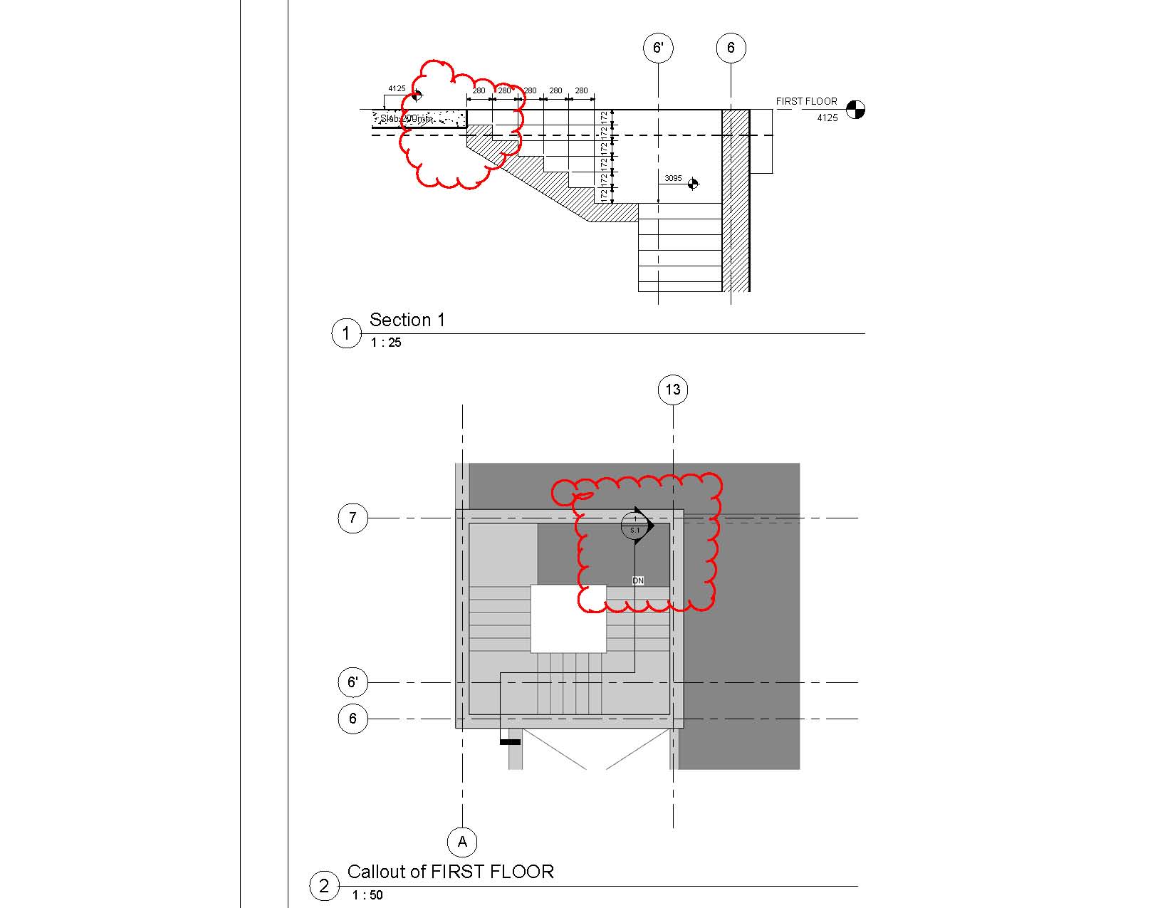

I have a stair with 24 risers from Ground Floor to First Floor. But when it reach to First Floor its waist slab is not joint with bottom of slab properly. Kindly see attached image & suggest the solution.Thanks.
Wed, Dec 18, 2013 at 3:05:33 PM | Stair not joining first floor slab properly
Typically we set a stair up like that to end with a tread.
