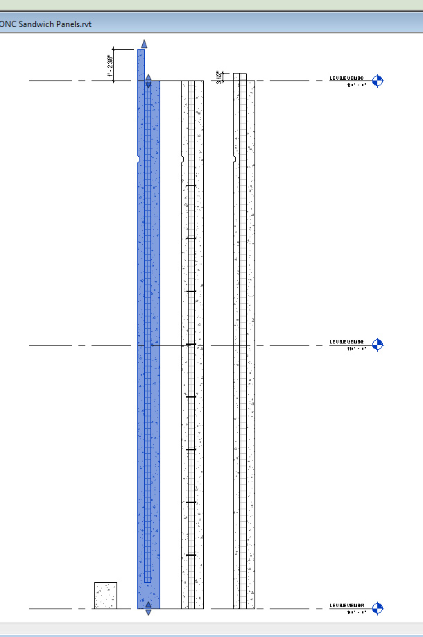

We are working with certain walls that are just not able to be modeled correctly in Revit.  So we are having to draw all of our wall sections in drafting views.  The drawing part for us is not a big deal because a lot of the sections that we already have drawn in autocad from previous projects can be reused and modified for future projects (and we have already converted the autocad versions into Revit drafting views).  Here is the issue.  In autocad when you draw a wall section, you have your elevation xref'd into the drawing and you use it to determine the majority of your horizontal dimensions.  In Revit is it possible/common for people to drag a view of their elevation into each of their drafting views to construct a wall section? If so, that seems like a pain but whatever.  The other option I see is to create a wall section and have it reference our model, which would give us a section that would look pretty horendous.  However, if those model elements could be put on a Defpoints layer in our wall section callout then we could still have that benefit of referering to the elevation/model when constructing our wall sections and allow us to have the desired wall section using 2d drafting lines on top.  Having the model objects behind our drafting lines would also act as red flag when something in the model changes.  If a Defpoint layer is not possible are there any other options to achieve something similar?

This looks like a typical 3-3-4 concrete sandwich panel.  I just completed a project EXACTLY like the image you showed.  I have no problem sending you my wall profile in revit 2013.  A couple things are different here and there, but if you reverse engineer what I have, you should be able to easily be able to create it in 3D rather than a drafting them.

Some of the major areas that I'm trying to figure out include: allowing the insulation to taper in towards the top of the wall to allow for more meat of the outer layer of concrete to be used as a parapet, have all 3 layers of the wall adjustable vertically (revit won't let you just unlock all the layers and move them independently, the most you can do is 2), and lastly have the walls inner layer of concrete wrap at certain door openings (at overhead door openings, not single metal door). Unless the best approach is to add hatching to the door family so it overlays the wall when cut in section.  The concrete also wraps at the bottom of the wall but I've already figured out how to make that happen using the split and merge commands.

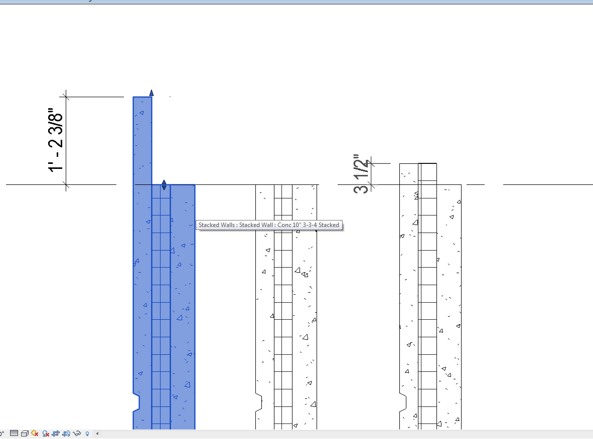

When we need the cut profile of a wall to be different in a view then the defined layers, we use the 'edit cut profile tool'.  I think you need to look at that.   That will allow you to "allowing the insulation to taper in towards the top of the wall to allow for more meat of the outer layer of concrete to be used as a parapet".
"have all 3 layers of the wall adjustable vertically (revit won't let you just unlock all the layers and move them independently"... << Revit lets you unlock adjecent layers.  Sometimes that means you have to think in reverse.  When you need to adjust both the inside and outside layer - you can't - Right?  Well, instead unlock all the inside layers and move those instead.
"....and lastly have the walls inner layer of concrete wrap at certain door opening" << Could this be solved in the door family?  If this not a 3D issue then maybe just using the edit cut profile in plan view works.

All edit cut profiles are 2D only and is therefore not available in the wall description.  But if you edit a wall say in plan, that same edit can be copy/pasted to any view that is the same orientation of the same components.
3d changes in wall thickness can be achieved by wall sweeps both in wall types or external and by in place families.  An example of in-place sweeps is here in this log wall post I did awhile back: http://www.revitcity.com/forums.php?action=viewthread&thread_id=17944
That same concept can be used for any wall profile.

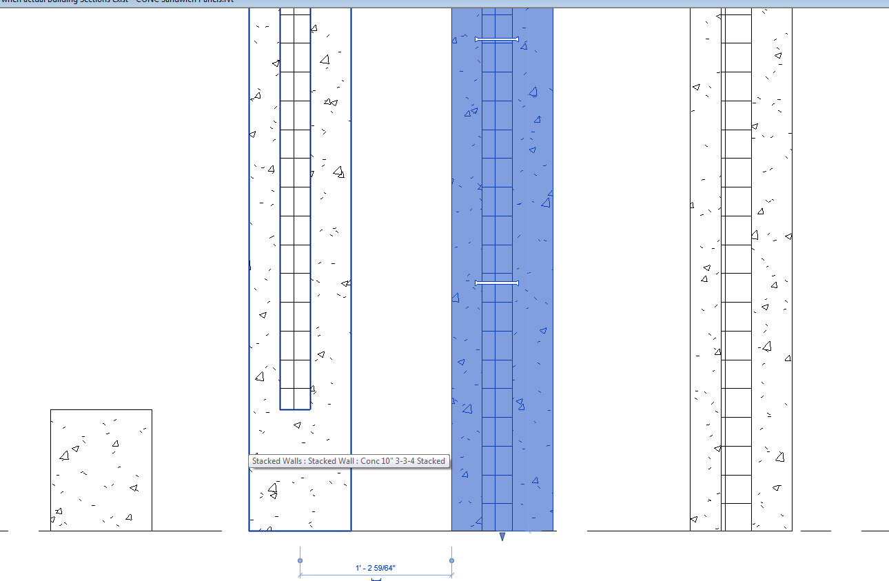

I take it you're looking for something like this... see attached.
What I did was create 2 wall types - both concrete, one is a 3-3-4 panel and the other is 10inch concrete.  Technically I created a third wall type that is a stacked wall to include a 1'-0" section of the 10" concrete solid wall beneath.  It is highlighted in blue.
I modified the top of the 3-3-4 panel to allow for the first 3"conc and 3" rigid insulation to move up and down.  the blue highlighted image indicates that I used a cut profile to take it from there.
I also put a reveal (or you could switch it to a sweep) for the 24" O.C. panel reinforcement between the panels.  that keeps you from having to detail component that thing in a dozen times. Winking
also, for good measure I created that 3" notched reveal you had.
Attached is the file with the walls.  I probably forgot a thing or two but this should be enough to get you started.  Winking
