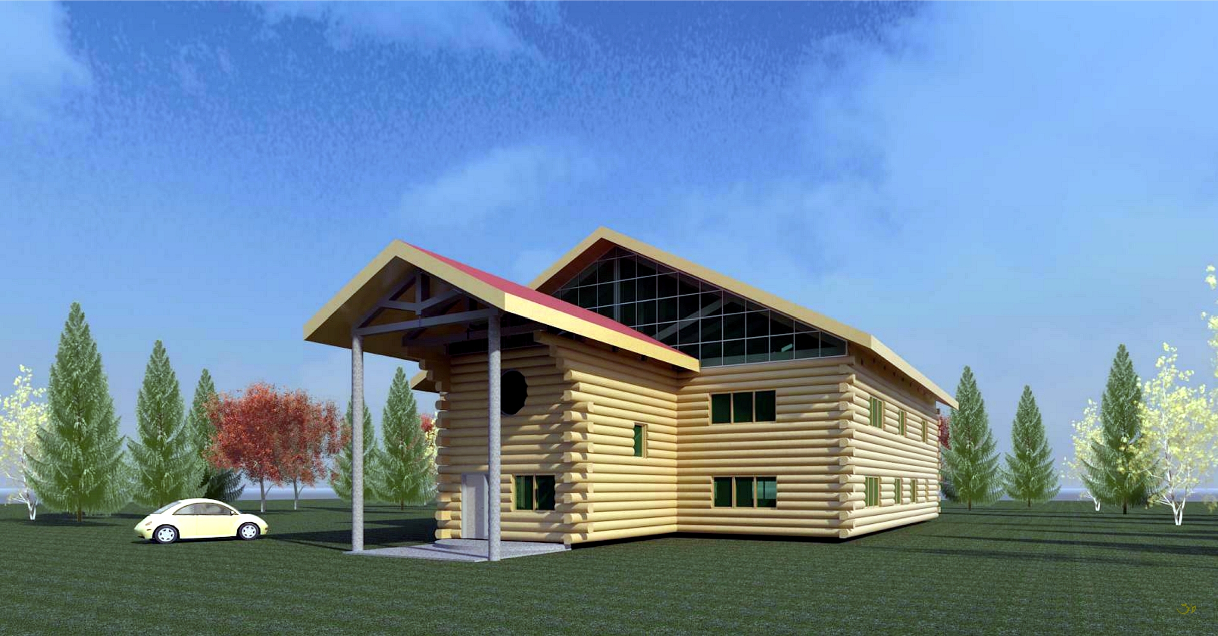

Using the wall sweep method, I created an 8" three sided log profile and stacked them up on a wall type to the height wall I wanted.  The profile is offset so the wall is inside the log profile.  Assign a wood material.  After placing the walls go to an elevation and select the wall sweeps.  One can individually extend every other log out beyond the end of the actual wall to get the log corner look.  Works good looks great.  I uploaded a rendering of a small building in log.

Here is a rendering of the resulting log walls
