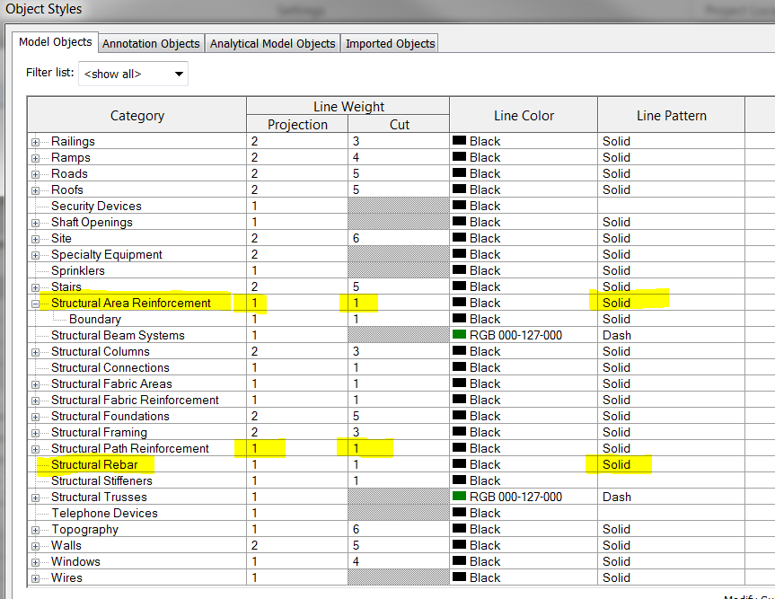

As per our company standers the top reinforcement should be in hidden line but revit does not give me hidden line in top reinforcement in my GA plan. other thing is how their isn't an option of additional bars....how can we designate bars as top add' or bottom add'. Thanks

I don't think 'area' reinforcing shows up in plan at all. Never has. Not sure why.  Additional rebar does however. The only control over the linetype is in the object styles. When you add the rebar you can specify whether it's upper or lower but you cannot differentiate the linetype between upper and lower.

Yeah if we change line type to hidden line it changes both top & bottom rebars to hidden lines which isn't a solution.......well regarding designation of top add bars could u please tell me how to designate bars like T12-150 Top add instead of default showing T12(3000)@150 Top. in properties it gives only top or bottom option.
