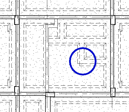

Please see the attach files and help why the slab edge  CryingTS1 Detail) are not join properly. Thanks

In order to have any sweep in Revit join properly, it needs to be done in a series, not seperate sweeps.  Remove your independent sweeps then click on the one remaining and add edges to that to create the rest of the sweep.

i did not use sweep command here it is slab edge................i don't know how to use sweep for thickend slab in project neither i find sweep tool in my project. Can you Please guide me how to do that. Thanks

A slab edge IS a sweep, so is a cornice.  They use the sweep process but in a pre-set fashion.  Use the slab edge and do as I suggested - one operation, not multiple.
