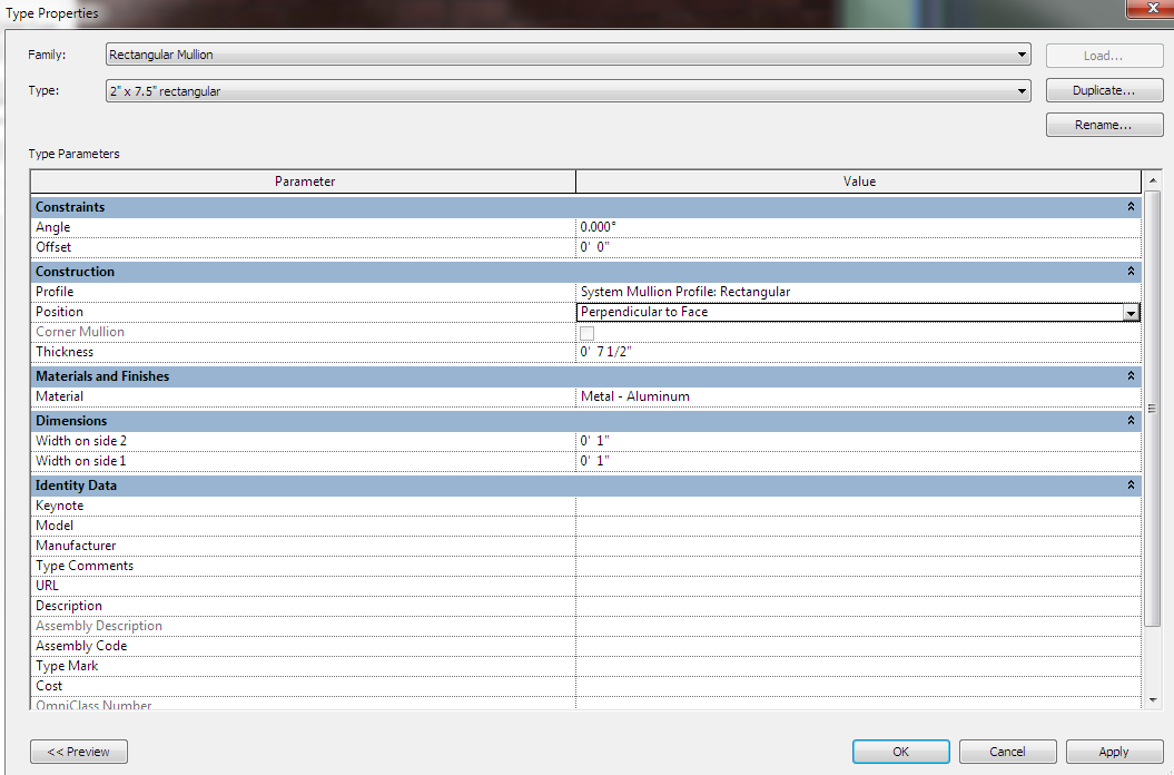

I dont think mullions and I get along too well. Here is my latest issue-When selecting the mullions of the edge of one of my curtain walls, I go to the type properties and want to check "corner mullions" since it is a corner mullion. However the option is greyed out (see image). Any ideas as to why? Am I going about joining my corners of curtain walls in the wrong way? Thanks

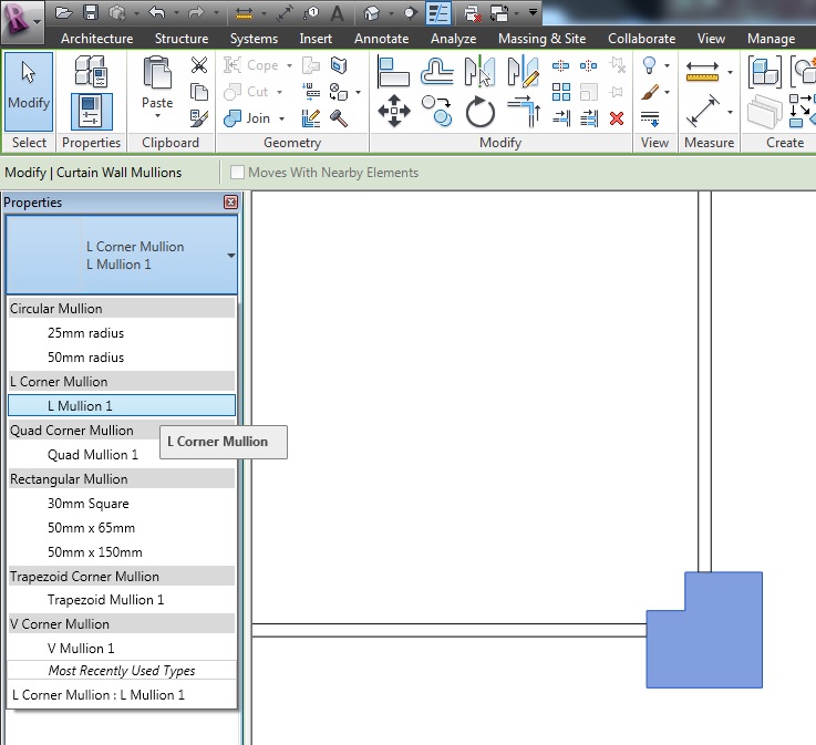

I don't think you can just change any mullion to be a corner. Start with a corner mullion from the default template and adjust its size and material from their.
Fri, Dec 6, 2013 at 11:05:58 AM | Corner Mullions
Your problem is probably that all of your mullions are defined in the curtainwall settings.  Either change the curtainwall to one that has no settings or unlock that element.
