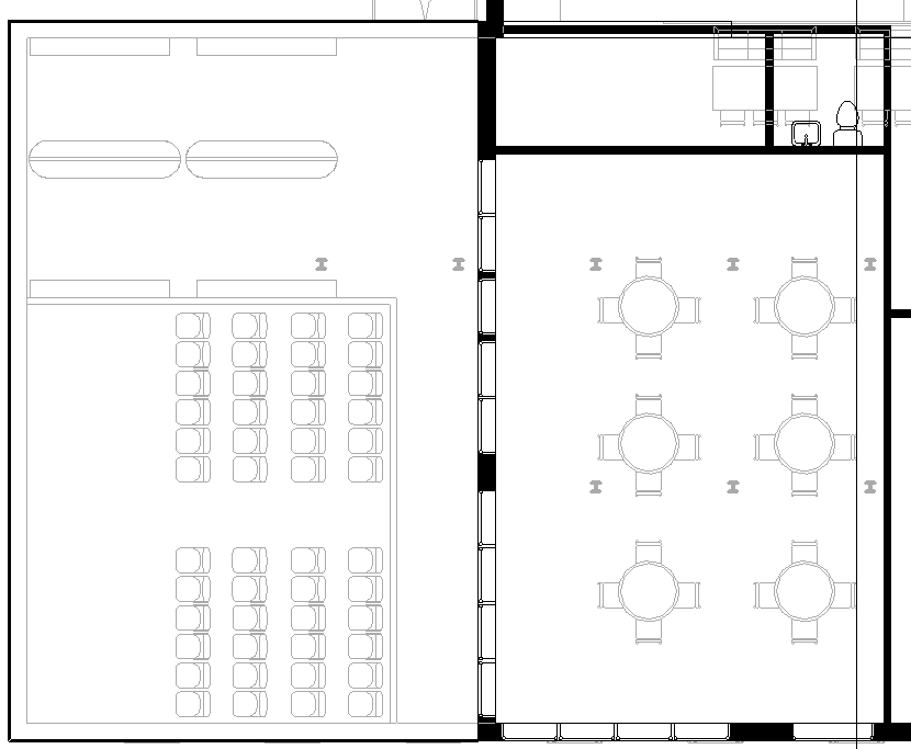

On the second floor, I dont want to see whats on the first floor beneath..how do I remove it from my view?
An example in my picture:
Wed, Dec 4, 2013 at 2:32:13 PM | How to remove the layer beneath on planview?
Change the depth of your view or if you have an underlay on, remove it.

Quoting WWHub from 2013-12-04 14:32:13
Ok, where can I find the depth of view settings?

In your properties under View Range

Thanks! Found it Smile
