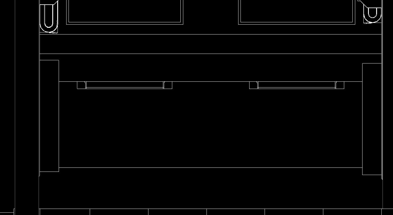

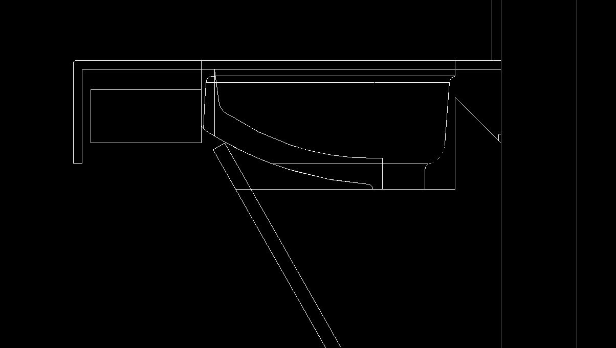

I downloaded this sink from Corian.  The void extrustion is cutting into my vanity front panel and is showing in elevation and the void is showing in section.  How can I make the void not cut the vanity and also not show in section?

I read that before I posted and it didn't help.  Thanks anyway.  I ended up using masking and filled regions to fudge the sections and elevations for now until I can fix it properly.
