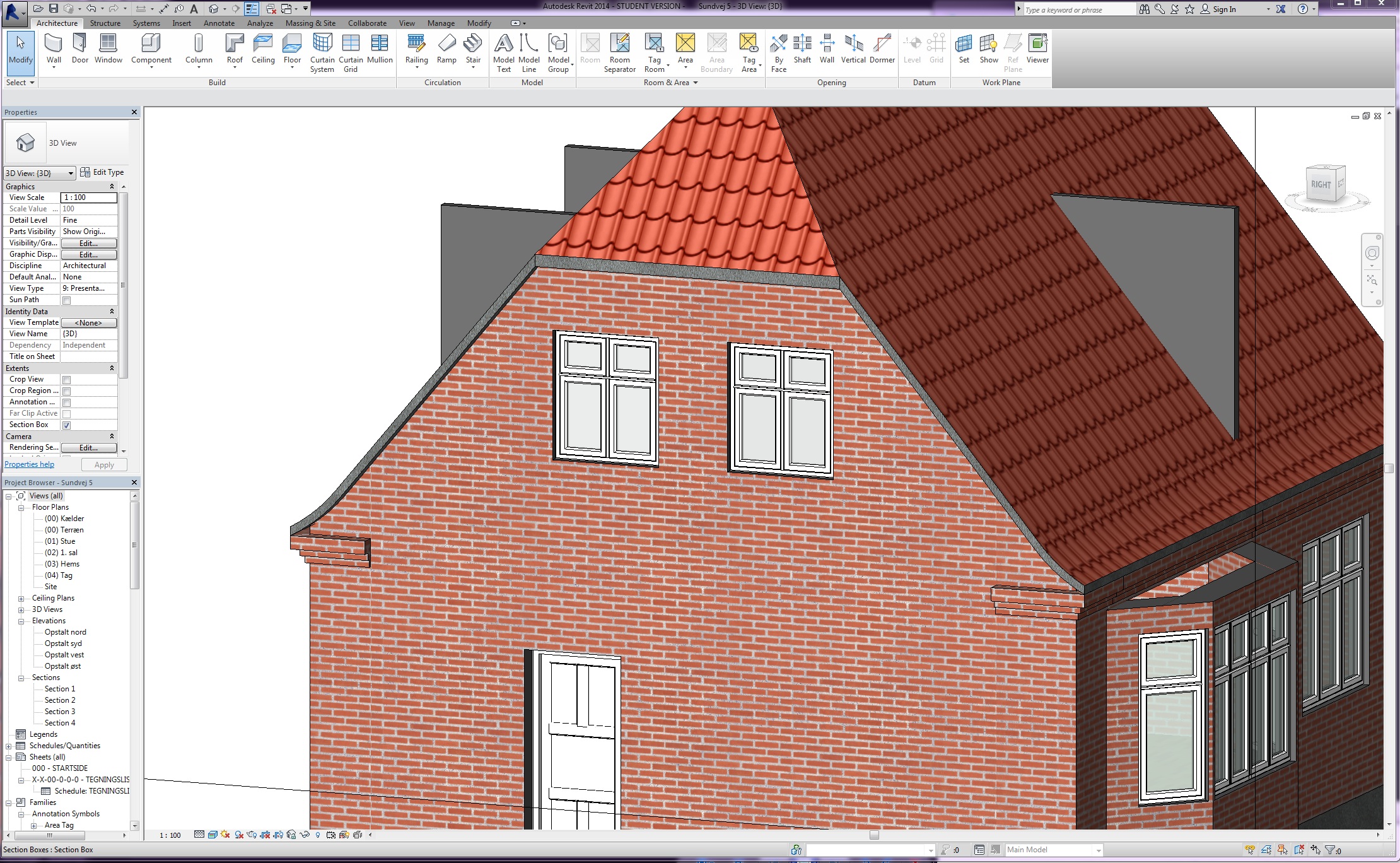

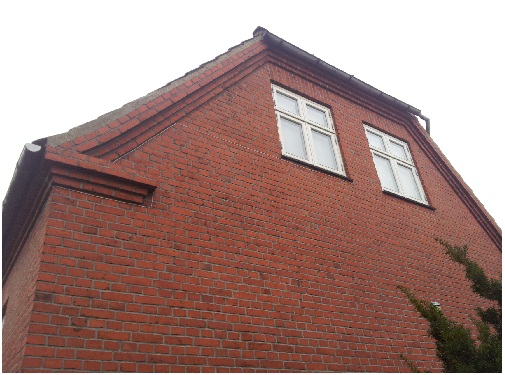

I am trying to do a sweep that will follow the edge of the roof (which is made from extrusion and added a sloped part at the top), but I can't figure out how?
I made the sweep profile as a simple "profile"-family and added it to the wall using "Wall Sweep". How do i get to pick or draw a path along the top of the wall??
I'm pretty new to this, so I'll need a step-by-step explanation Smile
Thanks - Janne

...and pictures!!

Use the "Fascia Tool" : http://help.autodesk.com/view/RVT/2014/ENU/?guid=GUID-CAD0E3C1-1B3C-4B5C-B399-A62AE3A0F360
Use your HELP

Thanks for your time Smile I should have known it was so simple! I did use the HELP, but it's hard when you think you're looking for something completely different Winking
