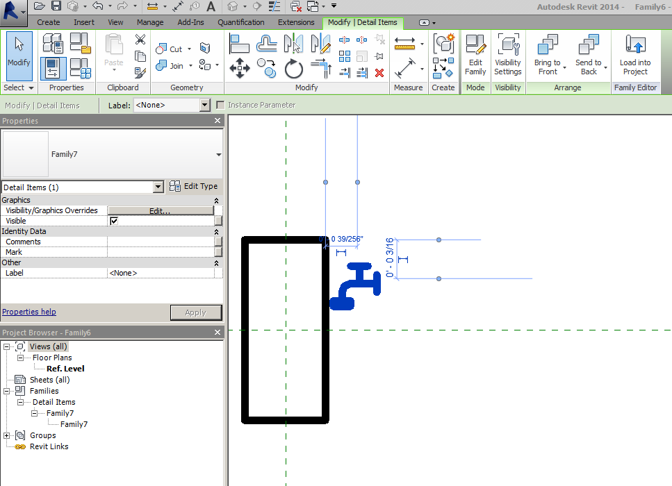

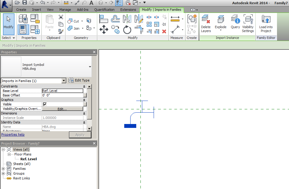

OK - here is my test:
Family 7 is the detail element with HB CAD DWG.
Family 6-7 is the mullion profile with the detail inserted.
And it works in a project.
Either your profile is not drawn correctly or Revit does not like your CAD.
