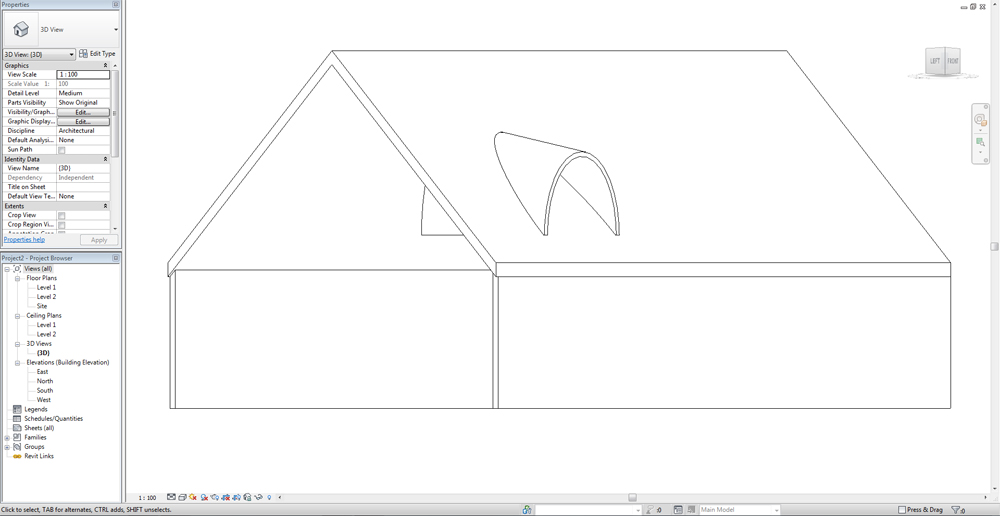

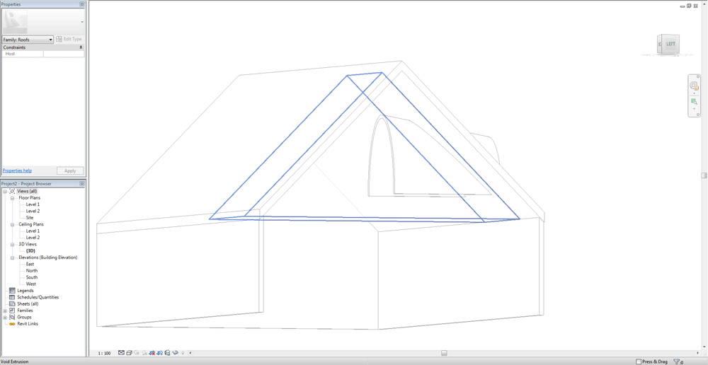

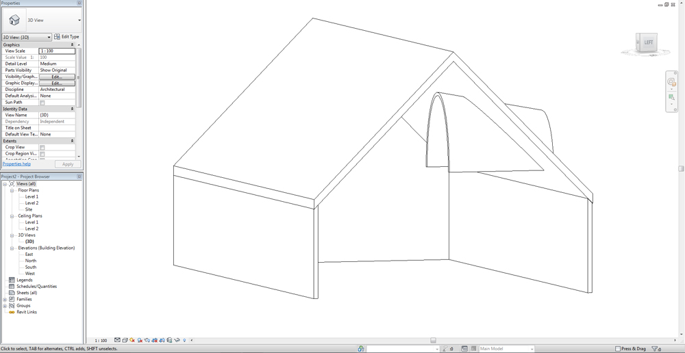

I've been trying to figure this out for ages. I know an in-place void will cut a roof extrusion (from the roof tab) but I can't seem to get any void to cut any in-place roof.
The dormer I want is not a half circle, but slightly stretched (elipctical) and slopes a bit. So rather than an extrusion I did a blend. If there are better ways please do share.
Here are images of a quick setup just to show what I want accomplished. I'm really thinking I'm missing something obvious here.
Thank you in advance

if this is still unsolved. you must create the void inside where you created your blend.
select the in-place, edit, create void, cut the void and blend, close the in-place editor.
and also, if you used roof by extrusion... model your extrusion a bit short, then use the JOIN/UNJOIN ROOF under MODIFY tab.. no in-place void needed to achieve what you are trying to do on your images.
