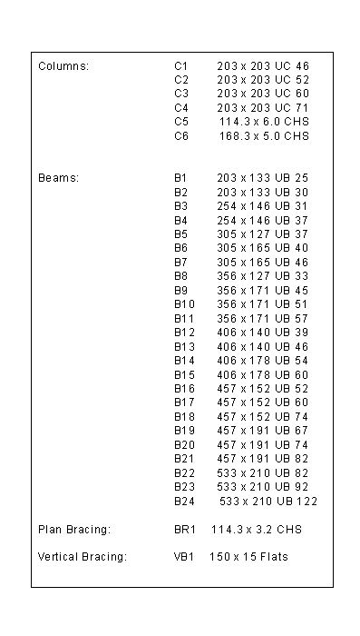

I am in the process of trying to produce a beam summary table whereby it only calls up unique Type Marks of each structural element, e.g.
B1 - 203 x 133 UB 203
B2 - 203 x 133 UB 30
B3 - 254 x 146 UB 31 etc... (Please see attached Summary Table.jpg that I am trying to automate)

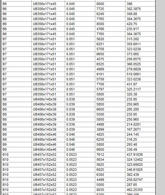

I am able to create a schedule calling up all the framing marks(see full schedule.jpg) but I only want to call up unique marks.

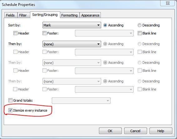

In your schedule properties under Sorting/Grouping uncheck the "Itemize every instance" box

Thanks very much. I have been looking for a tick button like that and somehow missed it!
