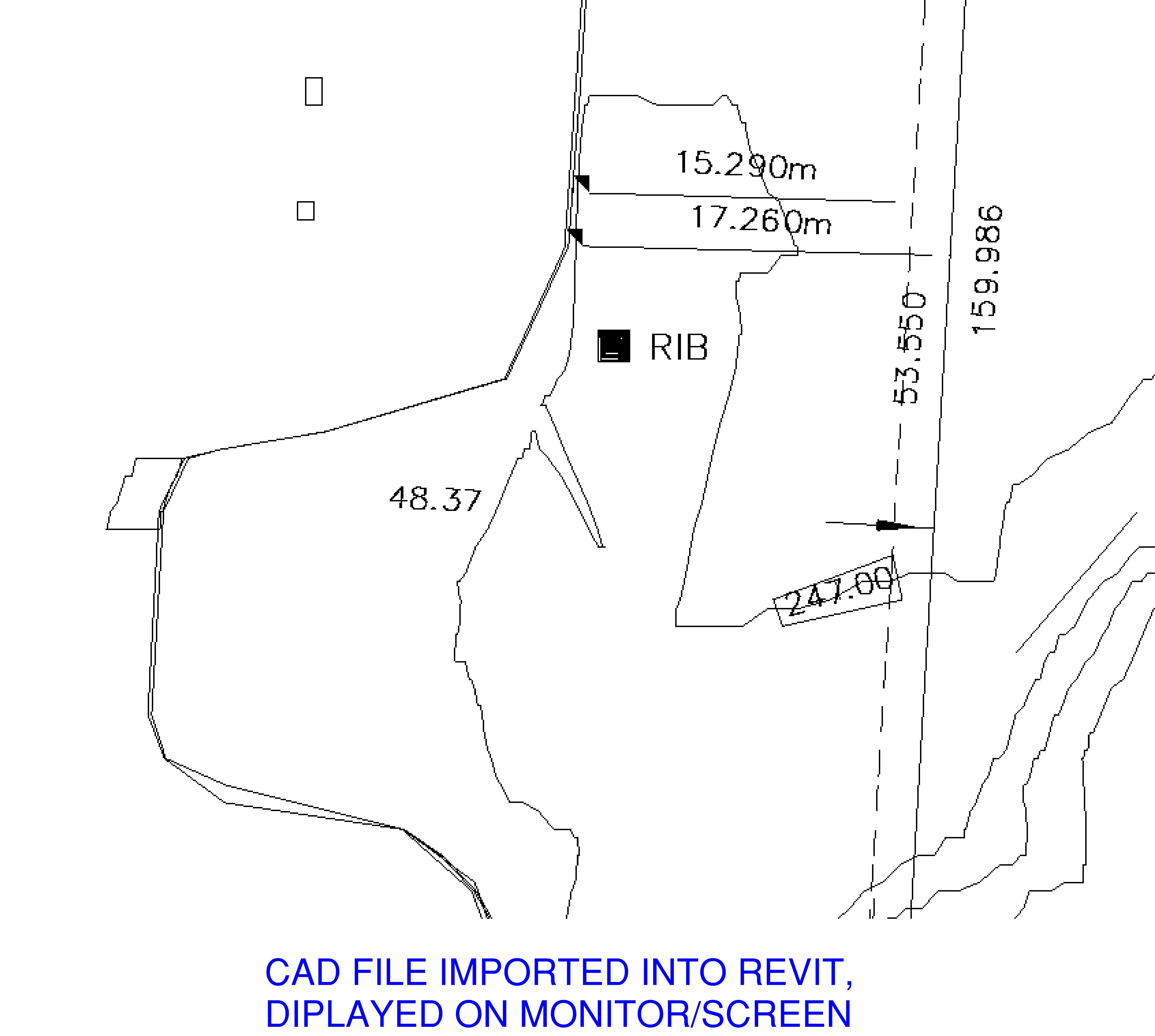

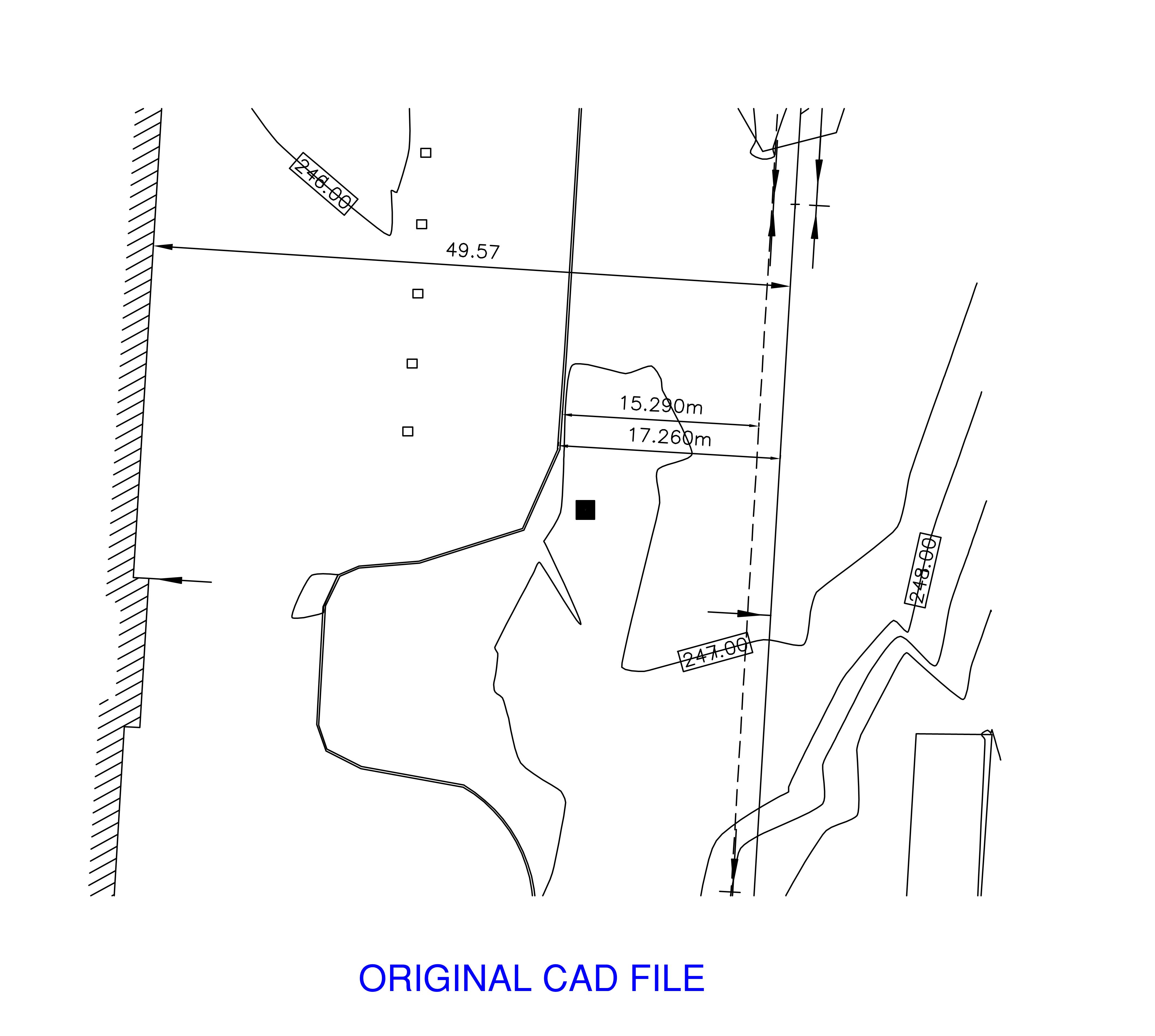

I'm having a problems with imported cad files. The lines and arrowheads are displaying incorectly compared to the actual CAD file. see images below.

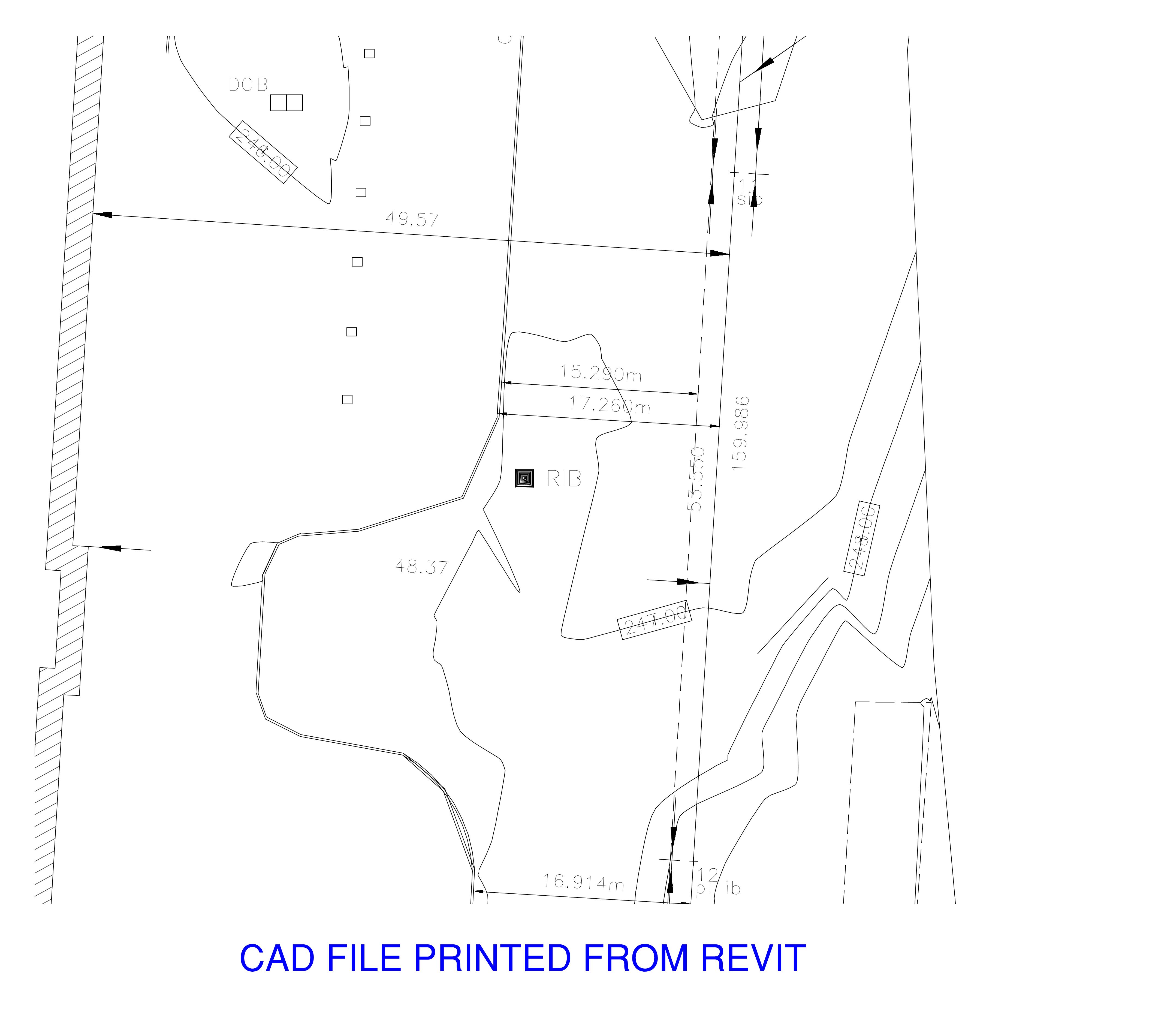

The funny thing is that if i print it from revit, the lines and arrowheads seem fine. Seems like a hardware or display driver issue to me.
Any thoughts?

Sounds like a grapics card issue.  Try turning off hardware acceleration
