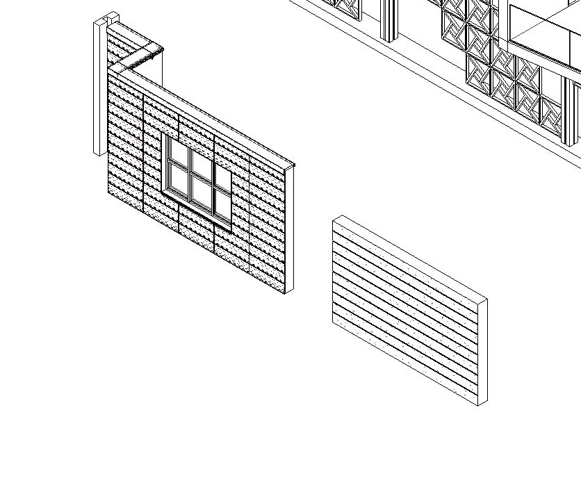

Hi all,

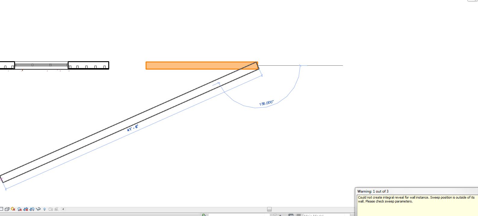

I am trying to make a wall from the Terreal Zephir Evolution facade, I was able to get the wall file and copied it into my project. However when I go to build that wall the vertical indent does not appear only the horizontal one. It gives me a warning that it was unable to creat the reveal because the sweep instance is outside of its wall but it is not, and I do not know where the sweep parameters are... At this point I really would appreciate help, I am so close.
Attached is images of my problem:
http://imgur.com/I5wX7El,PYMq9A8[1]
The first image is of the copied wall with the second wall being the wall I drew and as you can see there is no vertical lines to indicate the breaks.
Wed, Nov 13, 2013 at 8:49:19 AM | Unable to create reveal in wall instance? Please any help would be appreciated.
Vertical reveals are not part of a wall definition.  They have to be added afterwards.

Well if you dont mind me asking is there another way to get that cladding effect?
Wed, Nov 13, 2013 at 9:42:19 AM | Unable to create reveal in wall instance? Please any help would be appreciated.
A material will give you that effect and no need for any sweeps.
Wed, Nov 13, 2013 at 9:44:46 AM | Unable to create reveal in wall instance? Please any help would be appreciated.
Better yet - go to their site and get the Revit files:  (Did you think of looking there?)

yeah the wall i have in the image/ file was from their revit file I copied. I tried to contact them but to no avail yet... :/
ERROR: could not create integral reveal from wall instance. fail to cut wall.
