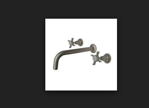

I want to make a faucet that comes out of the wall. so im making a wall based family. but how do I define a sweep line such that it comes out from the wall and turns down to pour into a basin. ie. sweeping a circle to make one trun down. cant seem to get a side view to draw the path line down to face the basin...does this make sense?
like this

Go to a left side view and draw your path then go to a front view and draw your circle foe the faucent side.

Exactly. but I go to the left side and I cant get a drawing plane to draw the line on :-(

Set your workplane to be that view.
