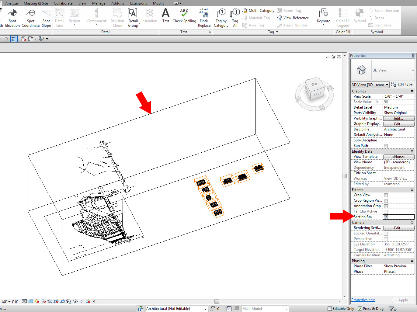

Hi, I am trying to learn how to import my views from Revit to be rendered in 3 D MAX in V RAY but when I import the view I want it  always shows my whole building site. What am I doing wrong? Please help me!

The only step you are missing is the 3D crop box.  Go to a 3D view, duplicate it with detailing (or not) and rename it something like 3dsMax View A - no site
Then adjust the crop box in Revit by clicking on it and adjusting the edges to show JUST the model you want.
Save Revit, exit that view
Open 3dsMax - Logo Icon - References - Manage Links.  Attach your revit model and select the view you just created (3dsMax View A - no site) in your revit model, the one you just crop boxed.  NO IMPORTING NECESSARY! LINKED !
