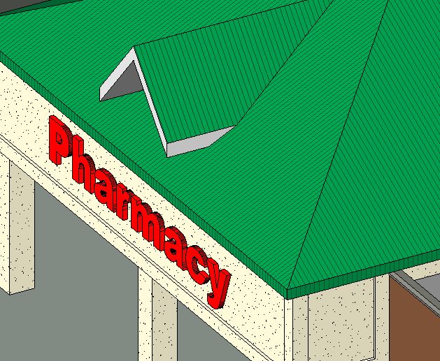

I opened the Comercial_Sample_Project and noticed that the Roof surface pattern wraped eaves.  I created a roof of the same type by extrusion and by footprint and the pattern does not wrap the roof.  Any ideas why this is happening?
Thanks.

You can use the material 'Paint' tool and 'tab' to select the fascia. You can also 'tab' to select the line pattern and nudge it to move the pattern and try to get them, to line up. Not sure if LT is any different however . . . .
