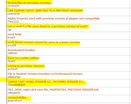

WWHub probably sounded a bit abrupt because this is far from a new topic. In the future you should try a few searches of the forum before you post your question because when you've answered thousands of posts (WWHub is close to 13,000 posts), answering the same question multiple times gets annoying.
A search for "Previous Version" yields a dozen topics on the same issue dating back to the start of Revit City.
A Good rule of thumb for Any forum (Not just RevitCity) is "Search first and ask questions later"
