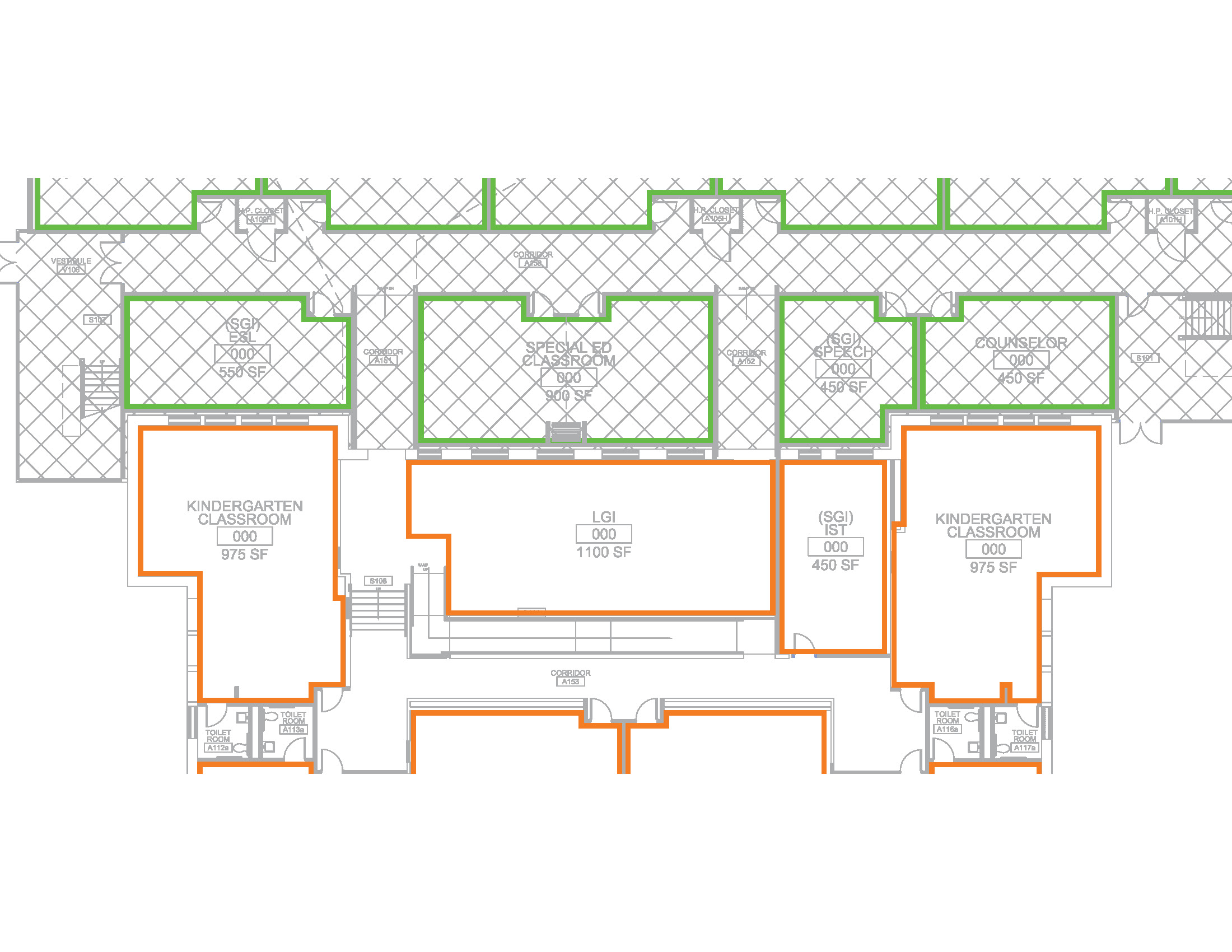

Hi. In our office we generally need to show an outline of the boundary of rooms and have them a bright color. Is there a way to do this easily, maybe edit the actual room boundary to show up as a color or maybe create a region by picking a room. I was planning on just using the color scheme and coloring the floor plan but the submission specifically indicates that the perimeter of the room needs to be "highlighted" in a contrasting color. I really don't want to do this by drawings detail lines, there has to be a better way. I attached a picture of what I need to show.
Thanks for the help!

hi
one way to do this is to go to architecture>room and area>area> and create area plan or area boundary,
by default there will be a boundary line in purple color.
-you can select and override by element specific lines to green and orange color (as per you attached drawing).
-you can select and delete any undesired boundary.
