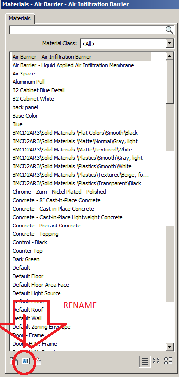

Thu, Oct 31, 2013 at 12:12:56 PM | Room - changing the title to room finish
See image

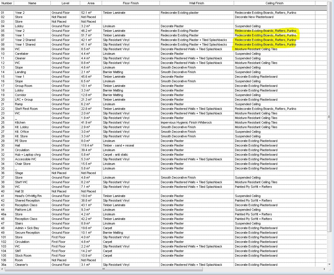

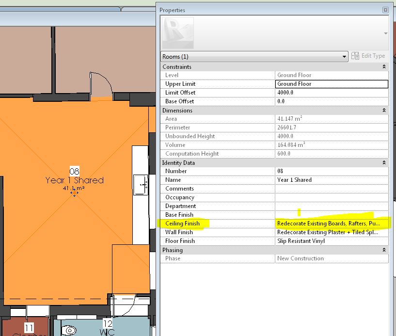

Oh dear... I may have this wrong on so many fronts!  I have been assigning finishes which are not yet associated to materials.
I have just tried to access the finishes through the material editor (like in your image?), but they're not there.  I fear I have either not explained well at all, or I am doing this wrong.  Please see images:
Thu, Oct 31, 2013 at 3:31:00 PM | Room - changing the title to room finish
OK.... Now I understand.
You have a schedule parameter in rooms called "Ceiling finish".  This has nothing to do with materials - it is just text.  When you have a value in this field, revit will show that same value in the drop down.  The drop down list is made up from all schedule lines in that column.   When you go to fill in that column in another room, you can pick from the drop-down list or add something completely new. If you change all of the fields in this column that had a particular value to something else, the old information will no longer be available in the drop down list.  You removed it - not revit.
