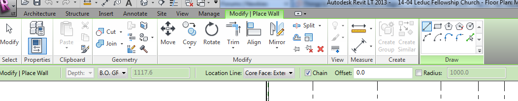

When placing a wall in the options bar the first thing on the left is an indiciator to tell Revit which direction vertically
you want to draw walls in, depth or Height.
For some reason on my new project this option is suddenly denied me and is greyed out. It will only let me draw walls
from "depth" meaning that it will set my base constrait to the level below the one I currently wanted to draw on. I can
not change it back. The program will also not let me change the base constrait to my current level (view I'm in) because
I then get an error about bad constraits because it is conflicting with the options bar setting which is somehow locked.
Why is this option on the options bar suddenly denied to me?! This is super frustrating and confusing.

You didn't understand my problem.
Revit it setting my base constrait for every wall autmatically to the level below the current level I'm working in.
For example, main floor, revit is setting my wall base constrait to my level below "B.O. Grade Beam"
See the image I attached, for some reason I am no long able to change this setting.
If I want to draw with a base constrait on main floor I have to create a view on the level above, "T.O. wall" and draw down.
It was not like this for my first project.

Your problem is probably that you started with the wall "depth" and drew one wall already.  Since you have "chain" checked, you can't change depth until you restart the process.

I just had the same issue! Depth greyed out while everything I was doing on the main floor was getting stuck at foundation depth. My problem was I took a 12" foundation wall, duplicated it, made it a main floor wall since I wanted the concrete as a core. The problem was in the wall properties that the function was still set as foundation.

Yeah you are right it was a wall property set to foundation. I realized this after and didn't update the thread. Thanks for clarifiying this. I think I did something similar with duplicating a wall and I was not aware of its properties. Ah the joys of being a nob newbie eh!
