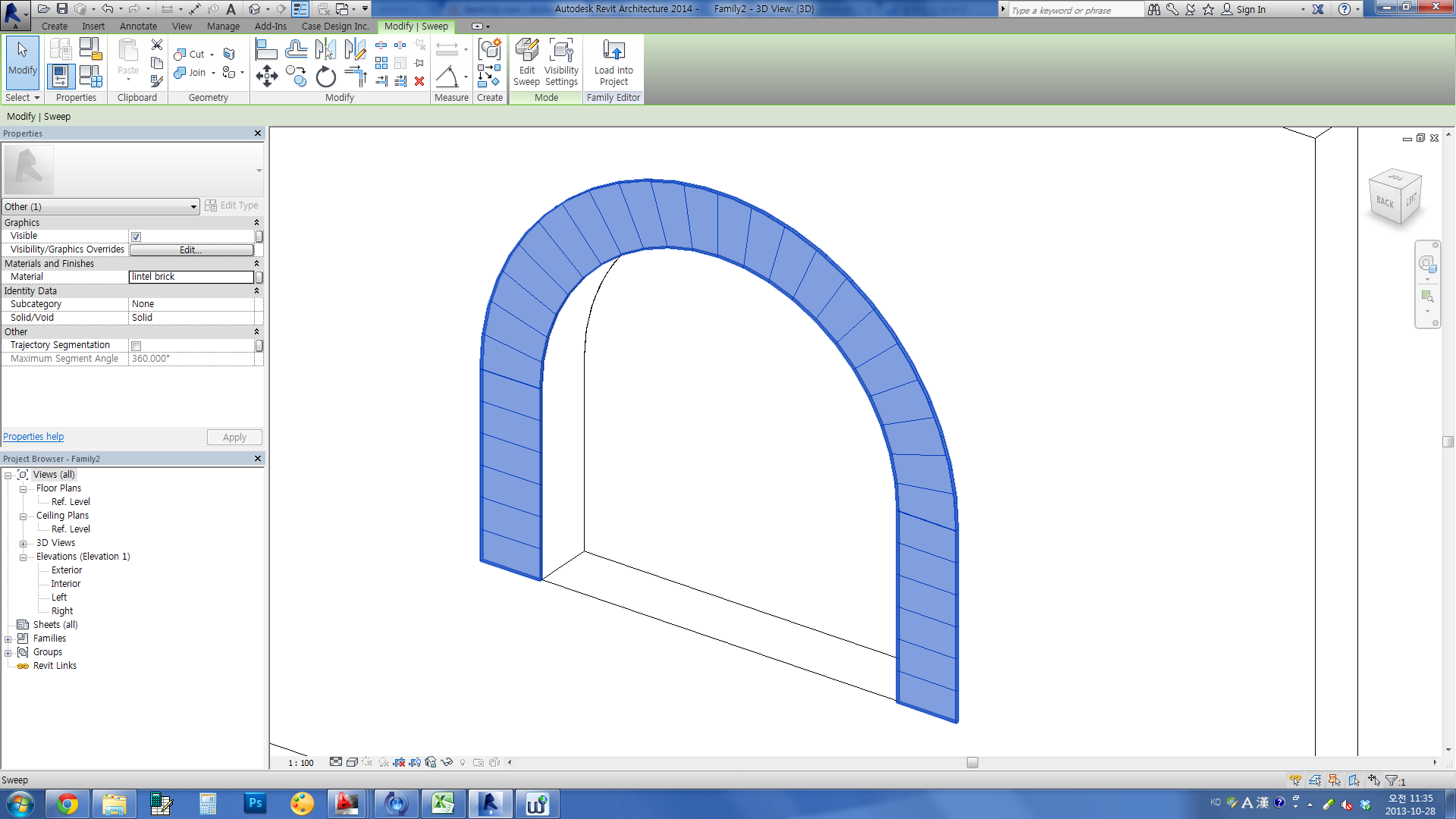

I don't have the videos anymore, MEGAUPLOAD is gone and I don't have time to create videos right now but create a Wall (Face) based family with that brick then in project use the Radial ARRAY, it's very simple...

if you don't want complicated model, you can make it with pattern like this.
http://youtu.be/4479DdEyOXg
