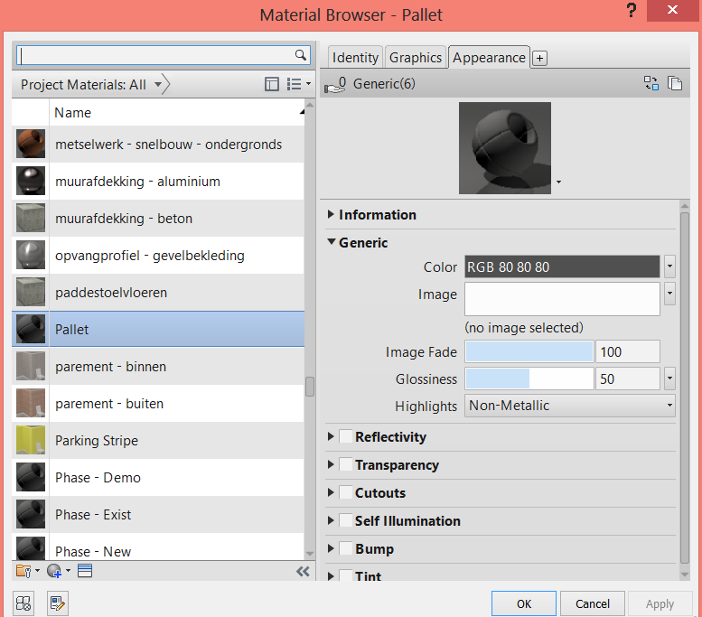

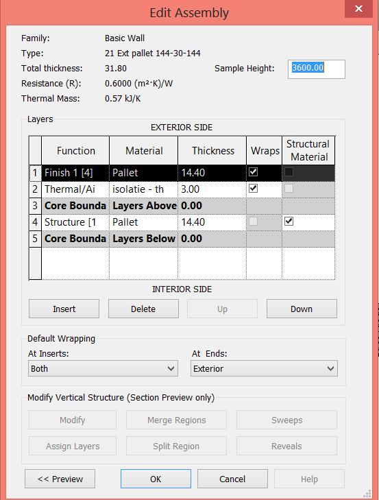

At the moment I'm designing a school completely out of pallets. I made one pallet as a model. And I was wondering if I could make a wall out of this pallet? In the edit assembly I want this wall construction: 144mm pallet + 30mm polyurethane+ 144mm pallet(with insulation in it). If anybody could help me that would be most welcome! Greetz Mirabelle

Just duplicate and rename a wall, then goto properties and change the wall like you want.

Hi,
I did this but I can't give the wall the appearance of a pallet.
The wall remains grey.
Fri, Oct 25, 2013 at 7:19:15 AM | Making wall from pallets
What you are showing us is the render appearance.  If you are looking at a shaded view, you will need to set that color as well.  You also need to set an image for your material.
