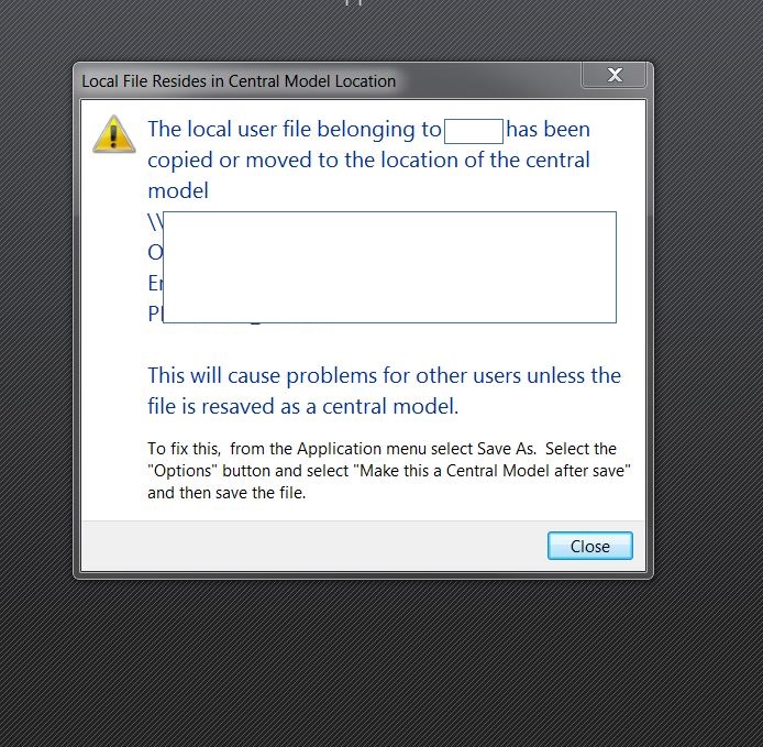

Yesterday afternoon I started getting a warning that my file did not save every time I tried to sync to the local. I could save locally but could not sync. I had been working in a project all day without any problems. I thought it might be an issue with my local file but I asked a couple other coworkers and they started having the same problem. I decided to open up the Central Model and I got this warning.  Anyone have this happen? I dont know what i should do.

I would assume that someone opened up the CENTRAL file and saved it.  By doing this all of the local files are now not able to be synced to the central file because they don't hold their relationship.
