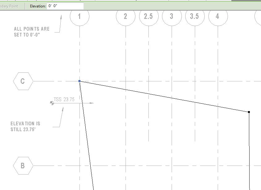

This has been driving me nuts, I'm not sure what's wrong...but it must be something with the way my file is setup.
A quick description:
I'm in Level 1 of my model with the site/location/coordinites set to 0', the Survey Point and Base Point (see attached) are also set to 0' at Level 1.  When I model a topo, no matter what elevation points I use (in this case, as a test I just put all the points at 0'), the topo is coming in 23'-9" too high.  I've tried to view the spot elevation from Base Point and Survey Point, same problem.  If I use the "Relative" option, it gives me the correct elevation, although when looking at  the model, it's still high.

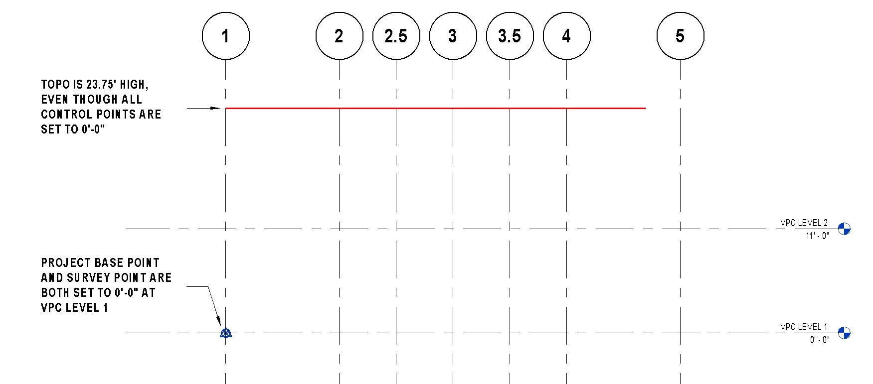

Thanks for the video, but I'm still having the same issue.
My Project Base and Survey are at the same exact location, so I don't think there is an error there (see the images in the original post).  The top is physically being modeled incorrectly based on the numbers I am entering.  If I want to model a floor, and put in a 10' elevation, it is perfectly fine, and shows up at 10'.  For some reason this is only happing with topo, no matter what elevations I put for the control points, it is being modeled at 23'-9" too high, I have no clue where that number is coming from.

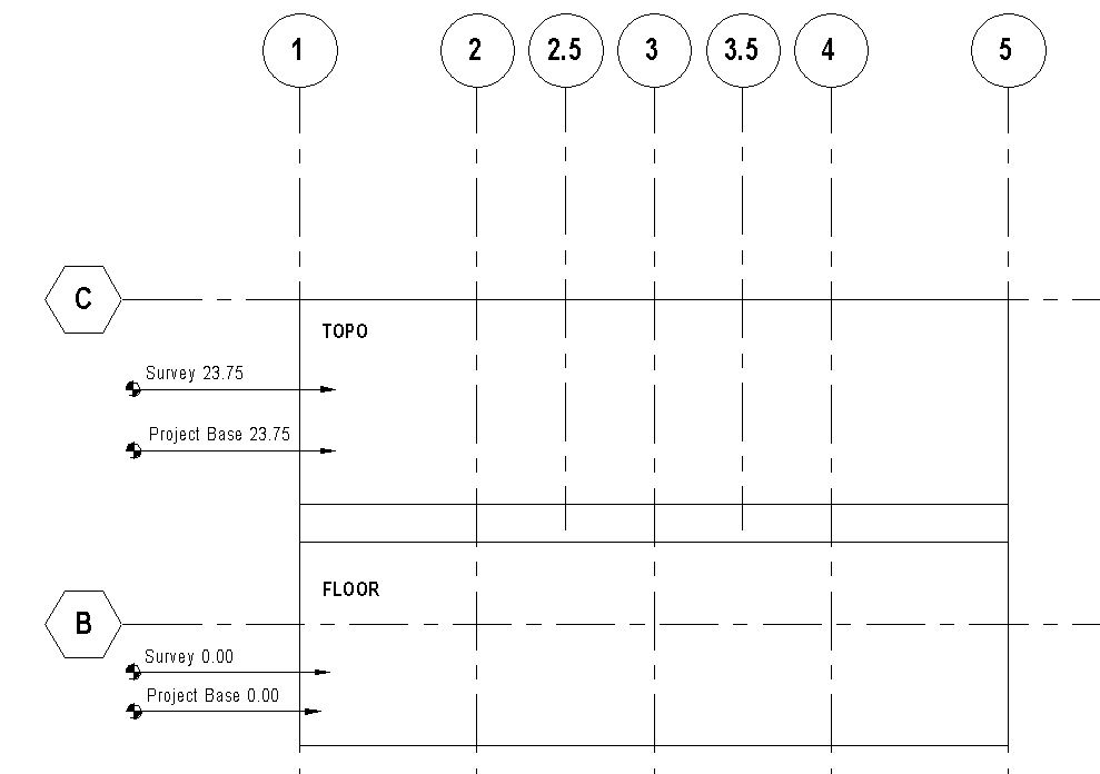

I've really been working on this simple problem for hours now, I even have others in the office doing the same. I agree with everything the video says (and I've done this so many times)....which is why I think something could be wrong with my file.
If you look at the attached images, I've modelled a Topo and a Floor, both with an elevation of 0'-0".  The floor is correct, the topo is still 23'-9" higher than it shoudl be.  You can also see in the images that the survey and project base are at the same elevation.

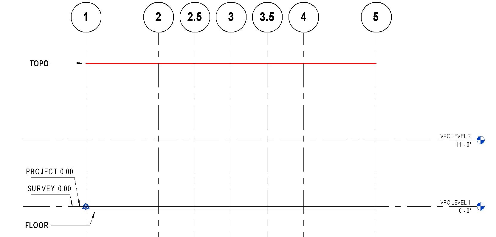

Found the solution from our Revit distributers help desk:
If I right click on the Project Base Point and choose “Move to Start Up Location” then the coordinates of the PBP reads as:
N/S -5’ 3 213/256”
E/W -169’ 1 7/64”
Elev 23’ 9”
So, that explains where the 23’ 9” is coming from. The solution now would be to relocate the survey point to that same origin / start up location and get both the project & survey points to read as 0,0,0. For future reference, keeping the project base point at the start up location is ideal. (Then you can use “origin to origin” when linking or importing files)
