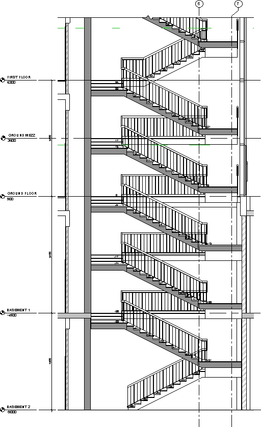

I am creating a staricase with varying floor to floor heights,hence i cant use the Multistorey top level option.
I wish to align every alternate balusters to the midpoint of the treads.
Can anyone tell me the process.
Image attached.

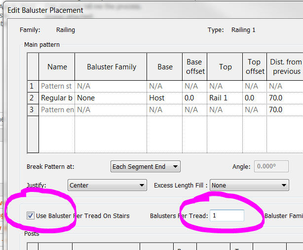

Not that it matters but your Tread to Riser ratio doesn't look right. What does the ballaster per tread setting do for you . .. see image.
