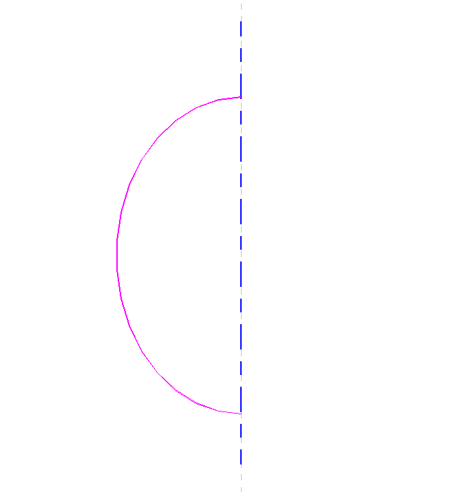

Yes, create a Solid Revolve (of a semi-oval), not in elevation but in a plan view, make sure to change the end angle from 360° to 180°. Then create a solid void to control the height of the oval.....see images....

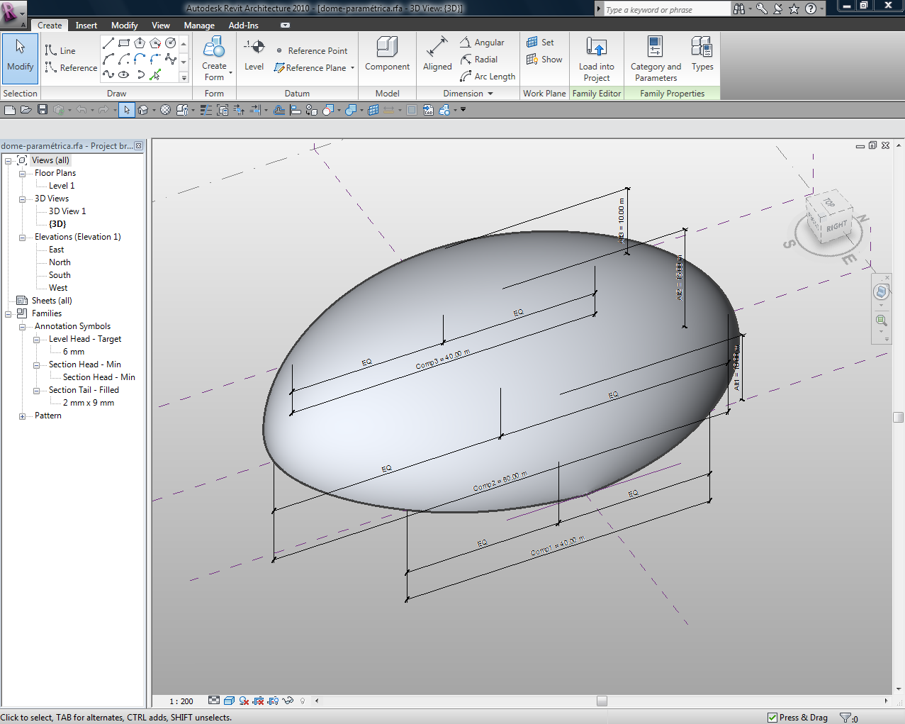

OR you can create that completly parametric...
See this video: http://www.youtube.com/watch?v=8N1wI5u7Kes&feature=player_embedded

Erland....when making the solid void which option do u use when trying to control the height. ive been using just the regular extrusion and it makes it look like a saddle. and ive tried using the revolve. but that just doesn't work right.
JD
