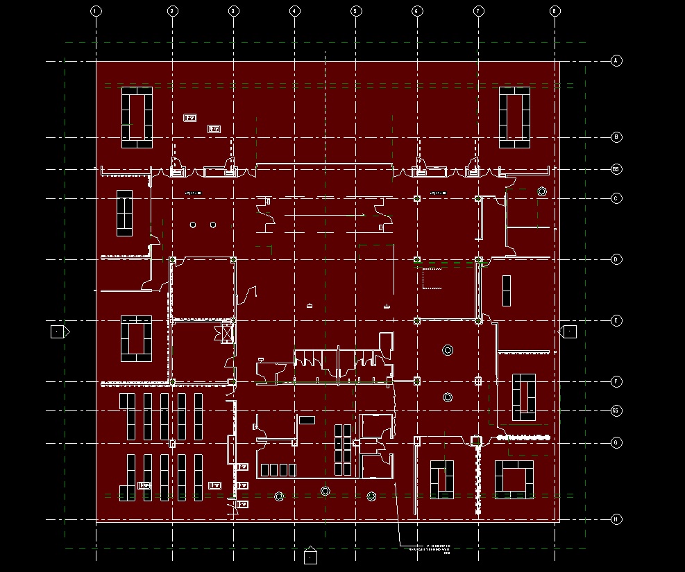

Hello everyone,
I am working for a lighting design firm going through a ftp site our newest Arch file seem to have something wrong. The enitre Linked area has this red hatch, has anyone had this problem and/or know anything I can do to fix this. I am working on deadlines so the sooner I can get this back in working order the better. I have attached a photo of the problem this is happen on 9 of my 15 floors.
Thank you,
James

We ask all posters to include their revit release and what updates they have installed.  This is a must.
You also need to give us more information if you want us to help but in the mean time, here are some things to look at.
  • If it is only on 9 of the 15 floors, then compare your VG between those.  Something is different
  • Make a view template from a non-red floor and apply it to a red floor - what happens?
  • Are you linking views?
