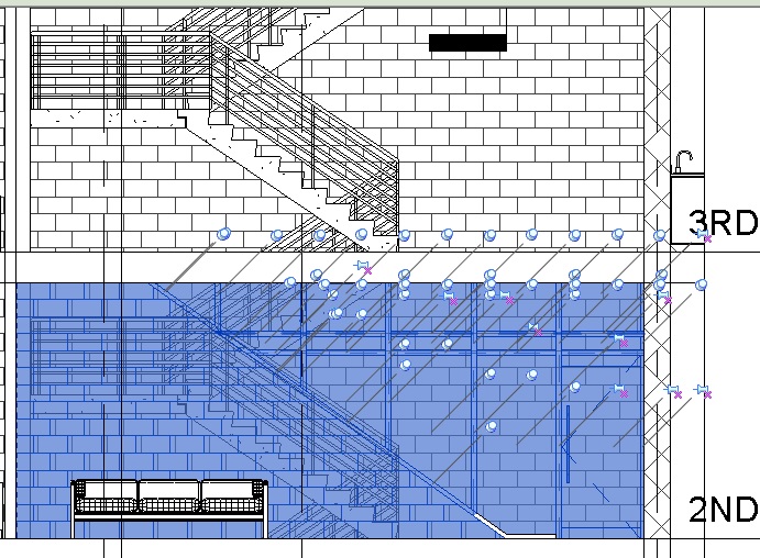

As the subject states I cannot figure out how to copy the wall section shown up to the next story. I have everything highlighted that I want to move but it will only copy left or right, not up or down. Parts of the curtain wall are pinned but I don't think that is the answer as no other wall will copy up a floor either. Does it have something to do with the reference plane? If so how would I change that? I am fairly new to revit. Know my basic way around just need some things clarified, Thanks.

just filter your selection and remove curtain panels, mullions, grids. then copy (Cntrl+C) and paste in selected levels. this option you can see in paste 'aligned to selected levels'
