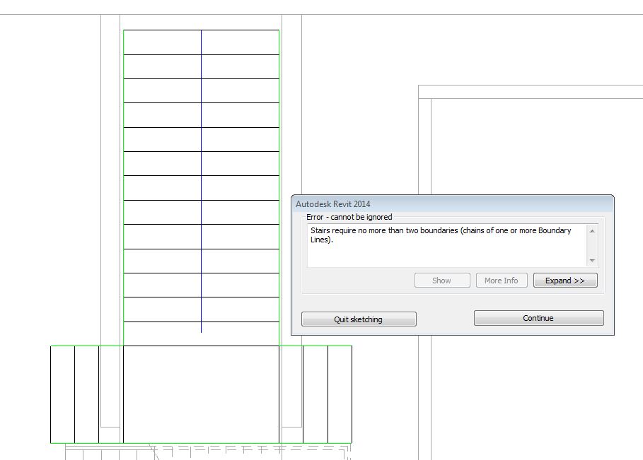

I remember there was a way to create stairs like this in 2011. How can I work around this 2 boundary limit.

Use stair by component
http://www.youtube.com/watch?v=0y3tQoaFAJU
