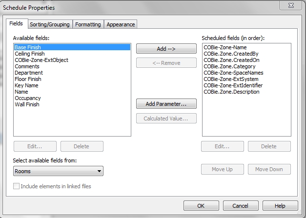

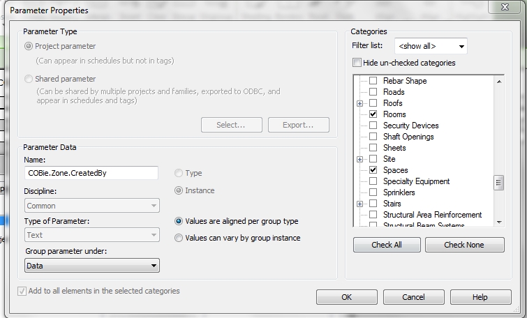

I wonder if any of you have some ideas for the following problem, I have created some Shared Parameters and loaded them into my project, they are zone parameters which are categorised under 'Spaces & Rooms' when I created the Shared Parameter as a 'text' input under 'Data'.

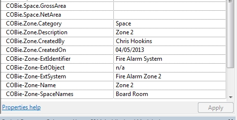

When I click on a room 'space' I can see the parameters in the properties section which I then fill in, when I create a schedule of those parameters nothing appears. I have been scratching my head trying to work out why it will not update in the schedule.

Your first screen clearly says these are project parameters - not shared.
