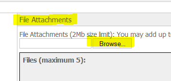

Attach the family to this conversation when you reply using the Attachments Button below. See my image attachment.
