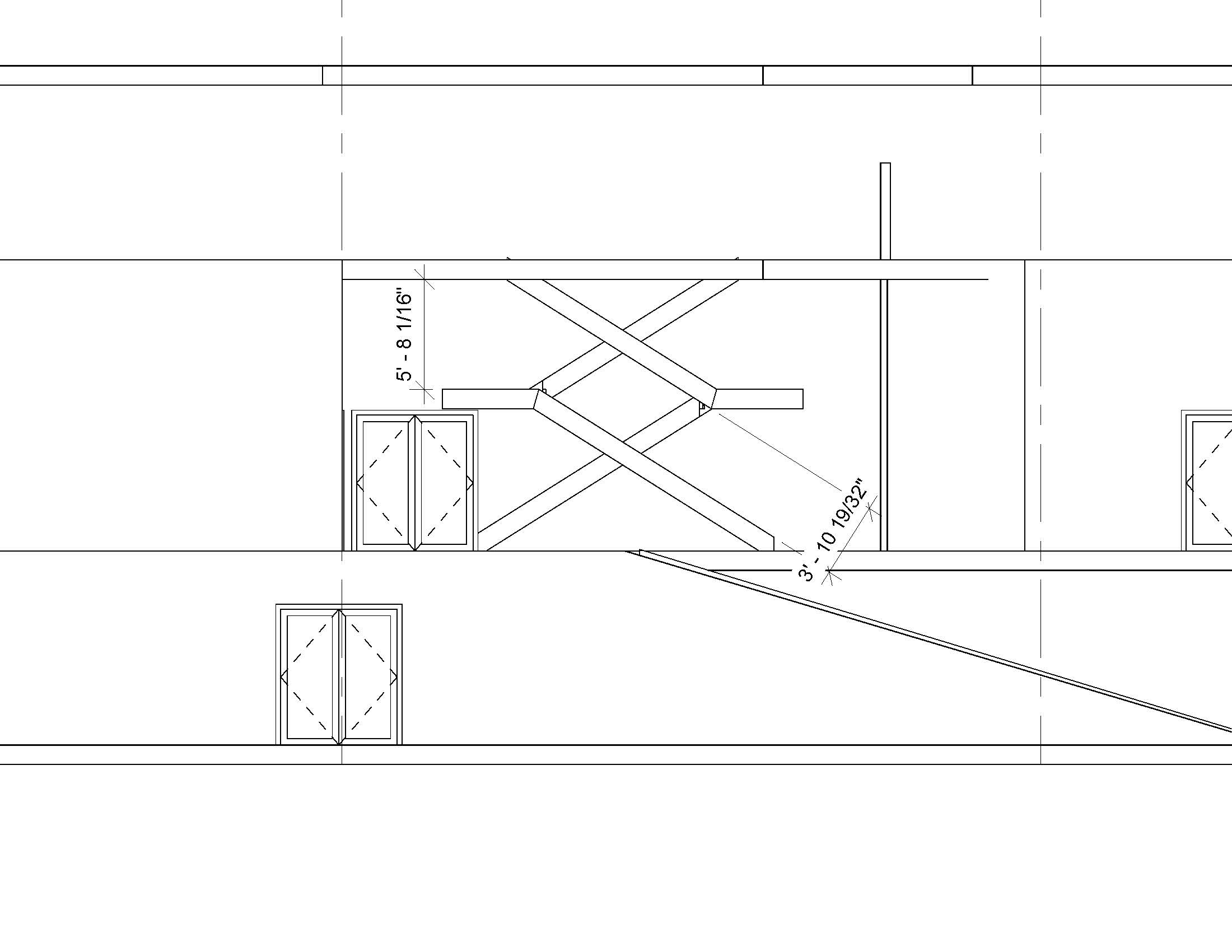

I have to make scissor stairs for my project. the height of the floor is 10'. i am honestly sure how to do this? i know this may seem stupid but i need help with this thank you.

Hi Sileeemo,
The headroom of that stair didn't comply with code.
If the floor to floor is 10'-0", then you have to use straight run stairs to make scissor stairs.
