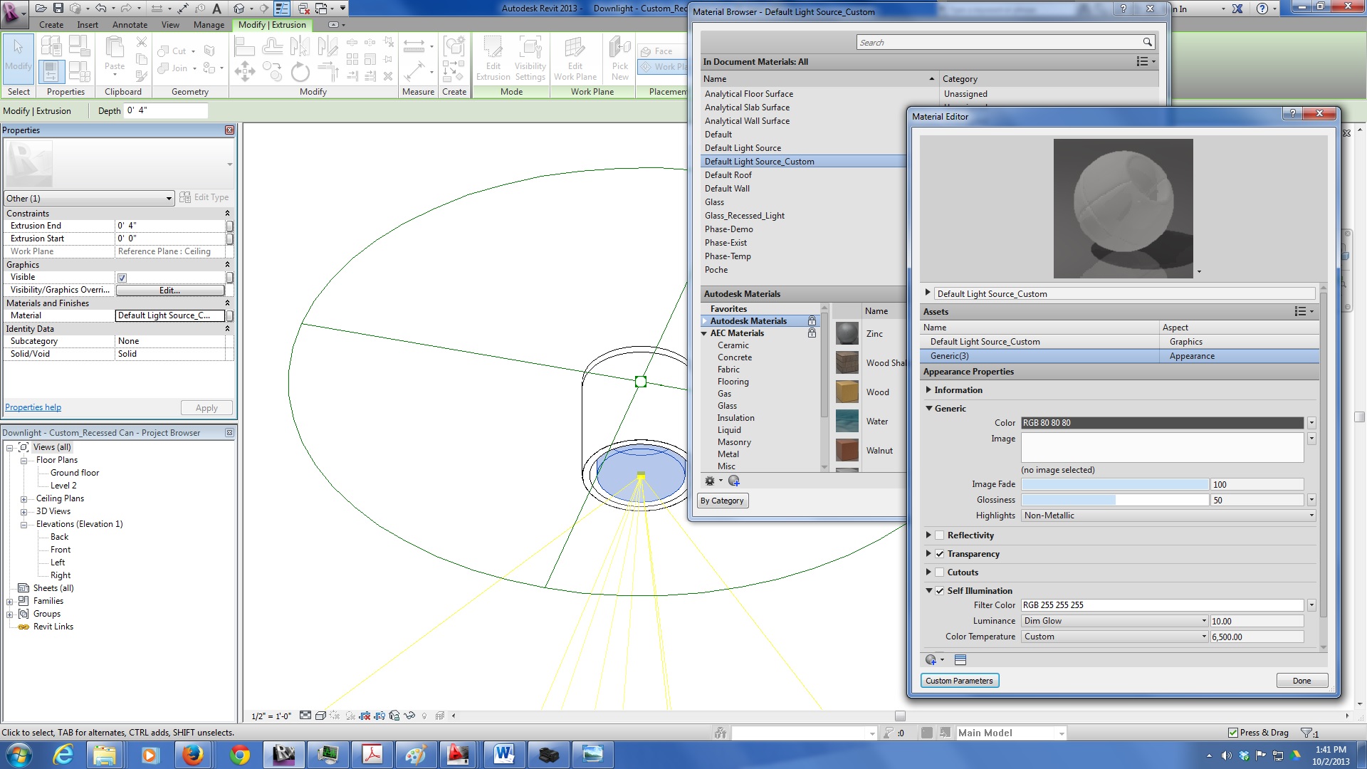

I know there's been a ton of threads about this and I read probably all of them and still don't get it right.

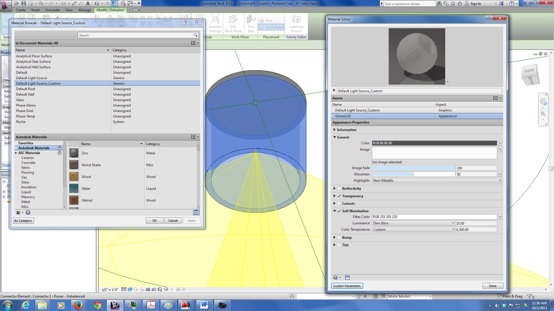

I'm using Revit 2013 - and the recessed can lights that come with revit. When rendered they always stay dark.
1. I changed the wattage like Typhoon said by 100...but it didn't do the job.
2. Self-Illumination is clicked on - also doesn't do it
3. I even painted the inside of the can - nope
4. There is no glass inside the recessed can...
WWhat am I doning wrong???I'm at my witts end...I'm sure it's something minor...any help as always highly appreciated.

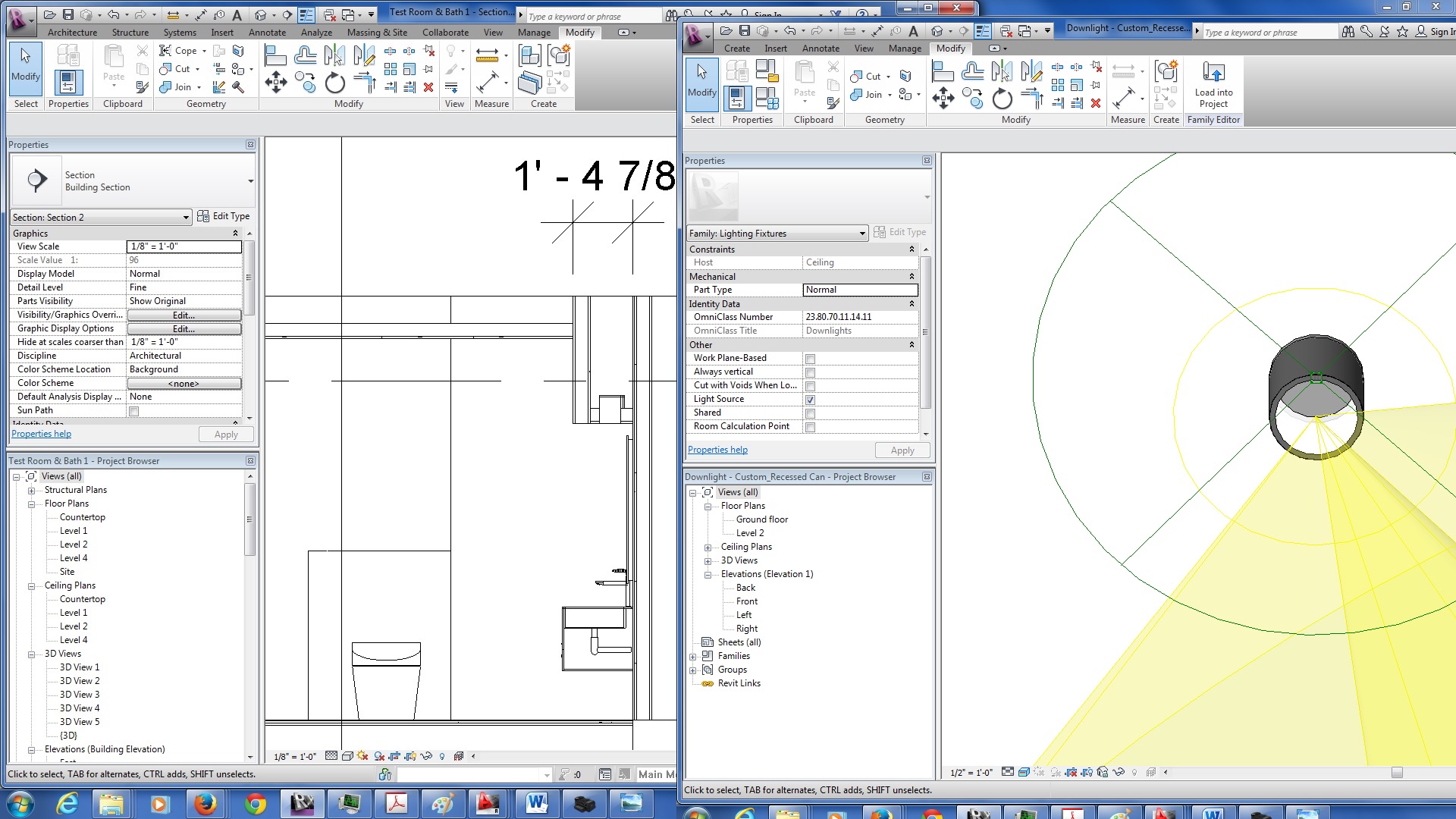

I copied the "original" revit fixture and placed an extrusion inside and called it light source...still not getting it.
Wed, Oct 2, 2013 at 3:58:10 PM | Interior Lighting - lights stay dark when rendered
You have a solid between your light source and the room.  Either it is the ceiling (no hole) or it is something solid in your family.   You will have to look again.

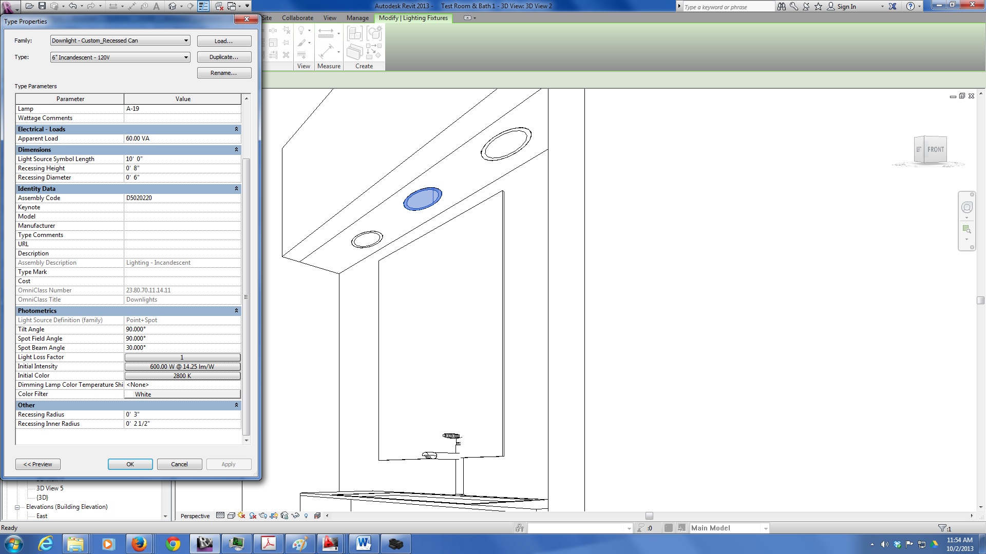

WWHub....so I checked again but I don't see a solid either between the fixture
and the ceiling or a solid inside the fixture ( I deleted the one I created earlier).

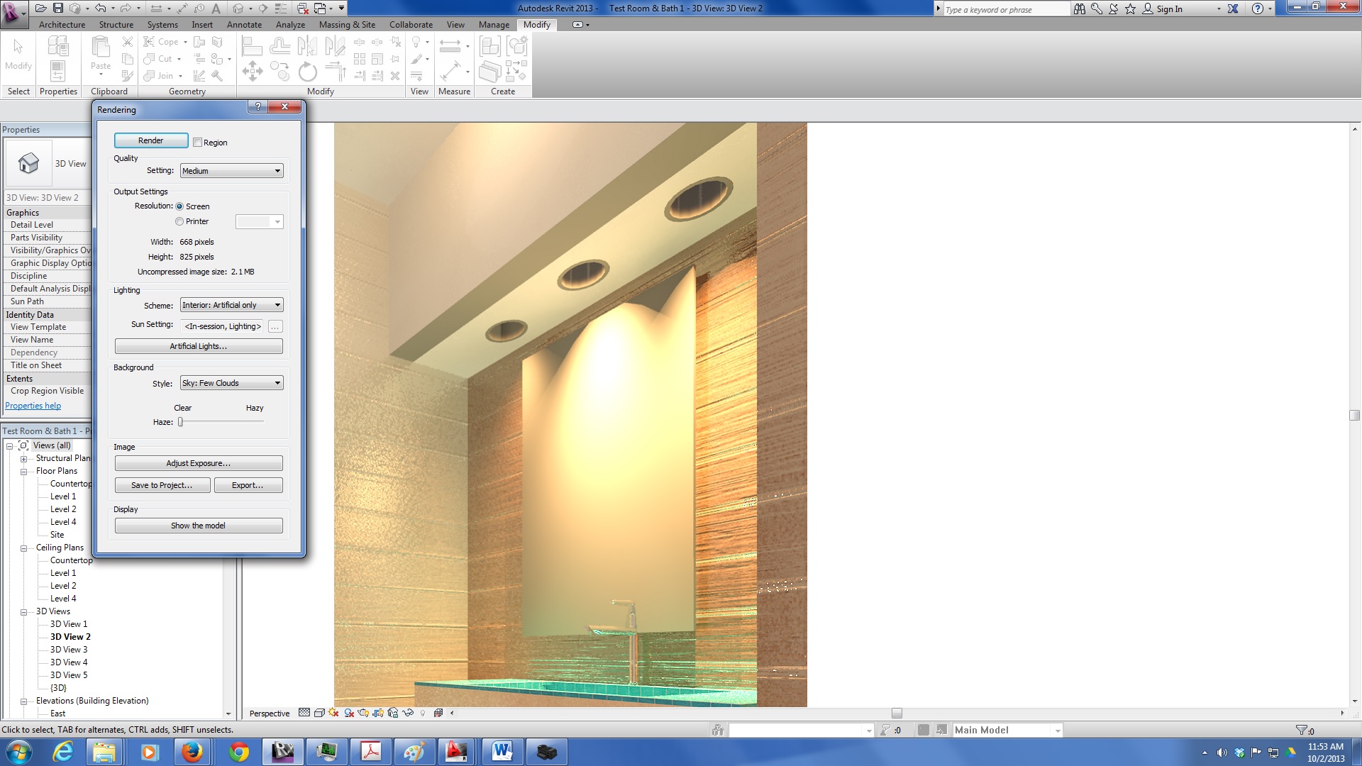

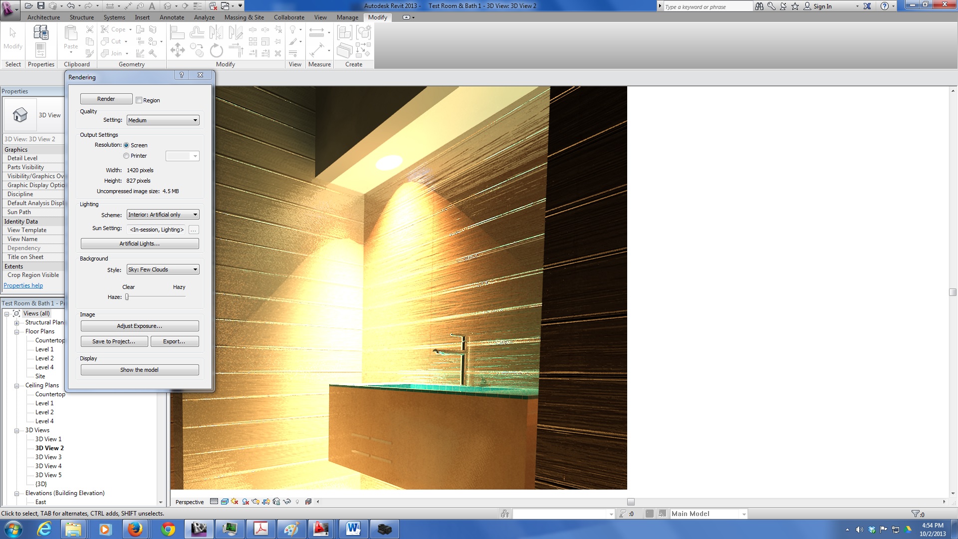

I moved the light source down earlier in the family as well but still doesn't light up. All I want is for the fixture (which is light can that
comes within revit family) to light up like the example I posted below that was done by someone else obviously.
Thanks for the all feedback.

I found the solution....

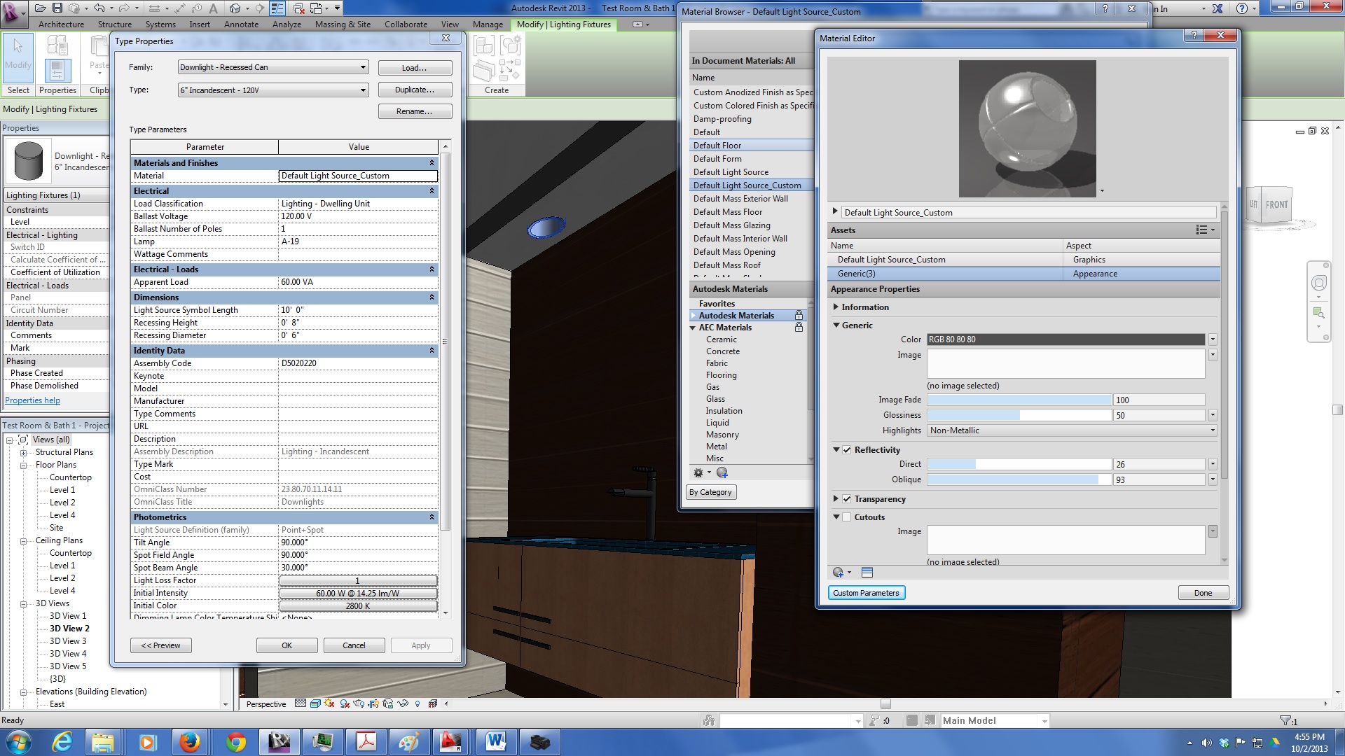

1. created my own custom light source in the materials library (probably not necessary but just copied in case...)
2. "Check" self-illumination box...
3. "Check" the REFLECTIVITY box...that's the one that was  un-checked the entire time..now it seems to be working.
thanks for all your feedback guys
