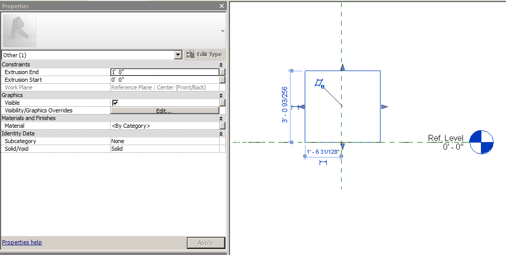

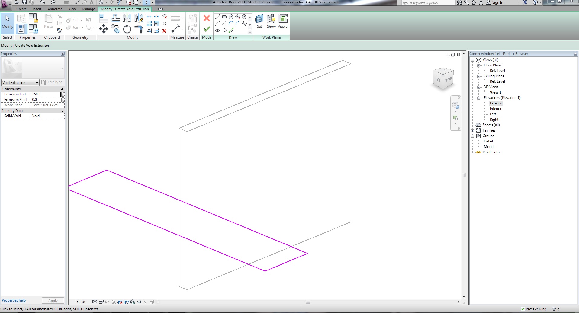

I am trying to create a corner window family in Revit.
I use the void extrusion command  but when I go to 3d view it is clear that the void is only a 2d plane (see attached image).
 Any ideas what I am doing wrong?
Thanks

Hit the green check to finish the sketch. You will then see a 3D void object.
Revit blog: www.bimeveryday.com

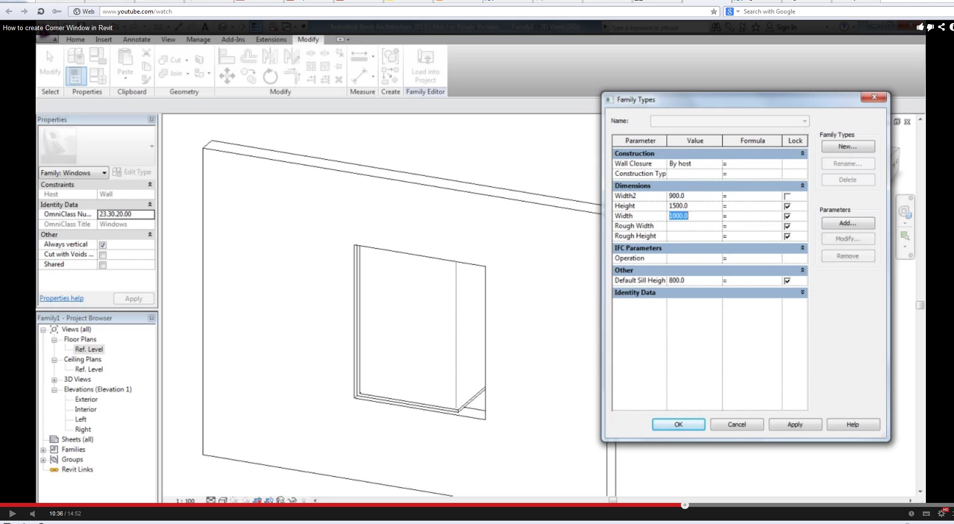

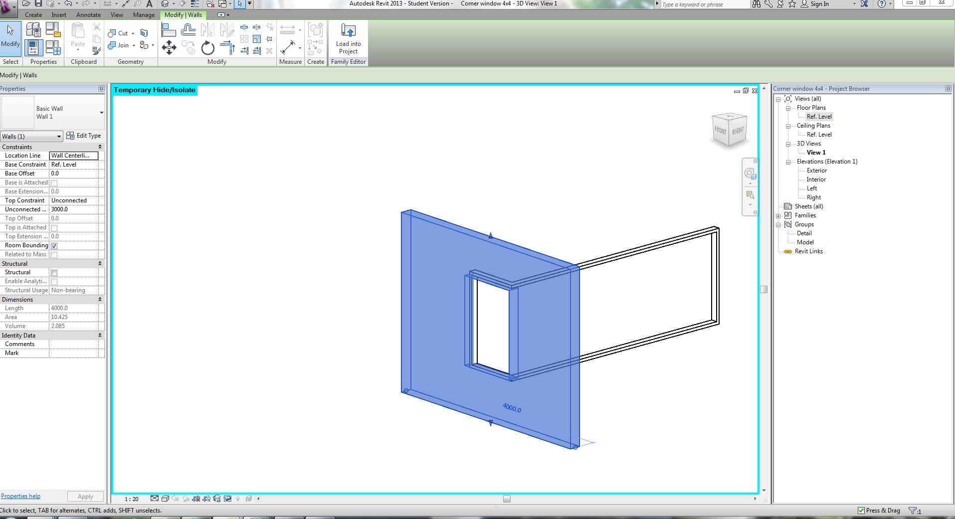

I am trying to follow a tutorial to create a parametric corner window in Revit 2013. So I am making a family object, parametric as all family objects must be,
This tutorial was created by abi3dtech and posted on Youtube.
http://www.youtube.com/watch?v=AmE4sWc8JSc
See the attached image “Corner window on Youtube.”  He can open the wall with all the parametric void options for the opening. This happens at about 10.30.
I cannot. See second attached image which is as far as I have got. Did I do something wrong in the earlier stages?

Tue, Oct 1, 2013 at 11:28:42 AM | Corner window family
CharlesDickens99
Joined: Mon, Jul 29, 2013
19 Posts
I seem to have answered my own question. It seems you select the wall and then click Family types command. The wall opening can be dimensionally adjusted and the window will parametrically follow suit. Can anyone think of other tutorials involving the learning of Family types?

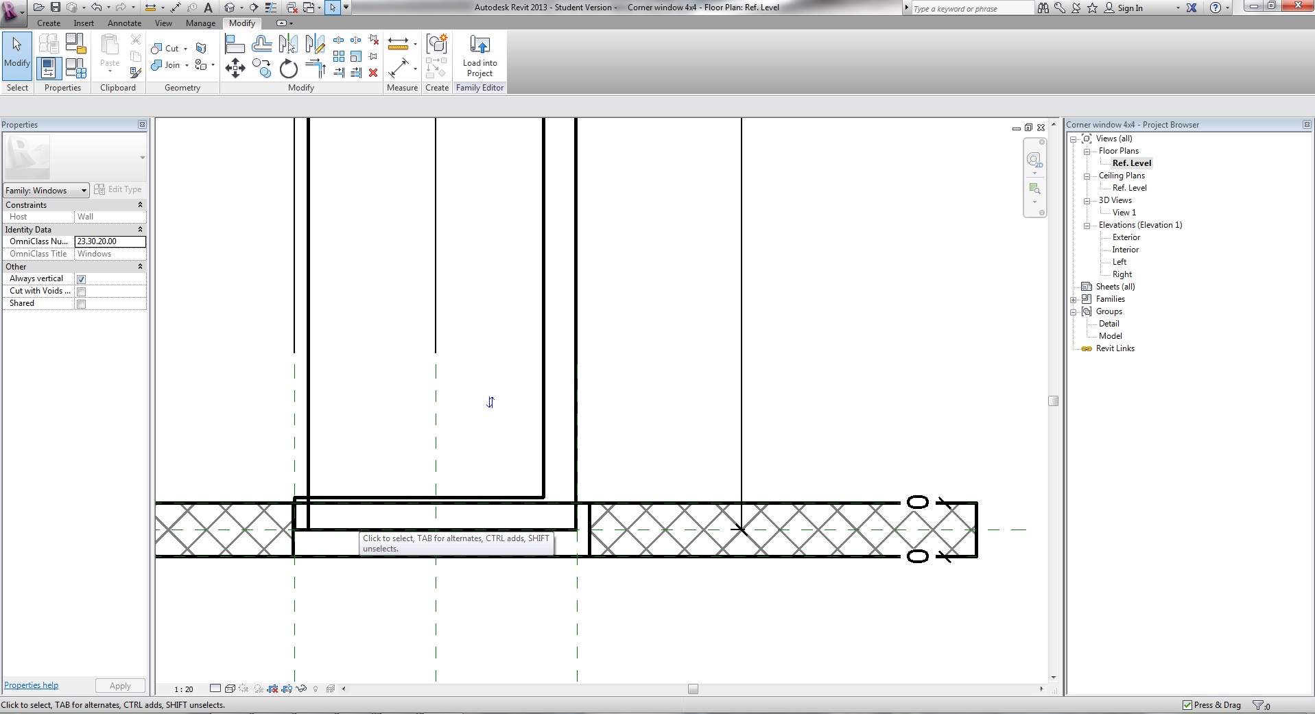

Another problem. I seem to have created my window in the wrong position. The edge of frame is on the wall centre line whereas I should centre of window frame at that point. I need to move it down 60mm. I don’t seem able to drag. Must be something to do with parametric properties. Any ideas?

I have read that extrusions are tied to the plane on which they are created. Once you have created it how do you tell what plane it is on? Sorry if that’s stupid but I am fairly new to this.
Thu, Oct 3, 2013 at 7:46:34 AM | Corner window family
Look at the attached image.  Ghosted property under constraints.

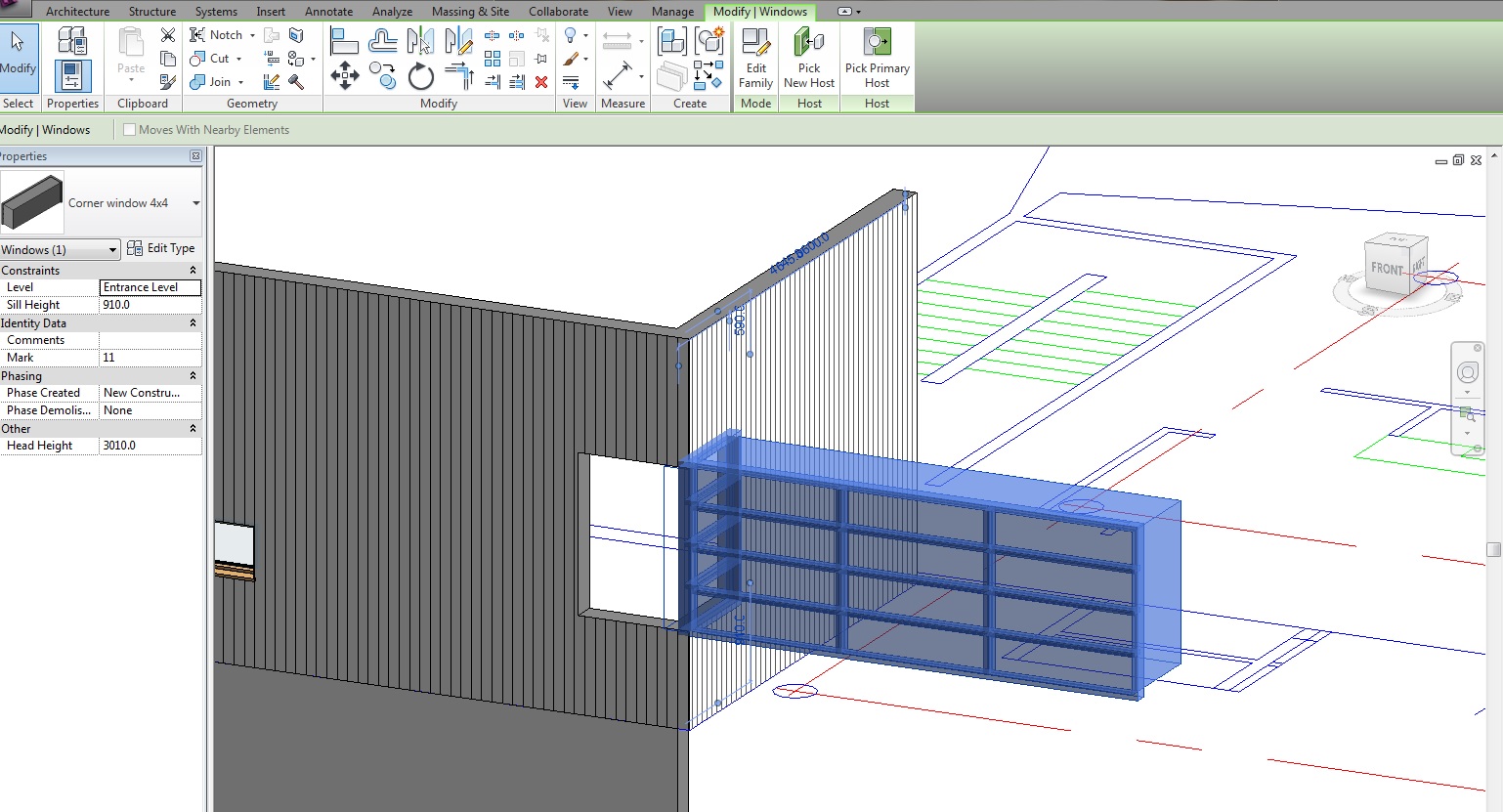

I am trying to create a corner window family in Revit and as you can see from image below am having problems.
I know someone will say read the help menu but that’s too dry. You need tutorials you can work through step by step, only way to learn.
I have dropped it into my project but two faces of corner window are not attaching to two faces of walls in building. Why is that? I can’t get it to rotate?
I have also tried flexing it before it went in. The shapes will move but not always the glass panes. When you click the lock icon when you are making elements in a family, the element will then stick like glue to any element whose face abuts with the new element? i.e. you are locking to geometry not dimensions?

Thanks for the help. Actually the first video by abi3dtech is the tutorial I am trying to follow.
Although the geometry of my window is different, I feel the knowledge should be sufficient.
I attach the family component I have made below. May be you could have a look at it?
Thanks in advance.
