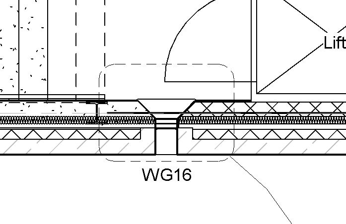

I have just noticed two instances in our model where wall build-ups have gone a stray.
In the attached image WG16 is a window placed in the external wall. This wall is one continuous wall running across the image. The wall build-up to the right of the window is displaying correctly. However to the left you can see that for some reason the inner leaf has changed to display as a concrete type hatch.
Second attachment shows intended wall construction
I really can't work this one out, it is all the same wall so don't see how this can be controlled. If I delete the window the whole wall changes to the incorrect build-up. If I throw a section through the wall it shows correctly.
There is another instance of this similar thing happening in the model but vertically as well.
Any ideas?
Thanks

Hide the wall on the left and see what's left.  I don't believe this is your wall.
