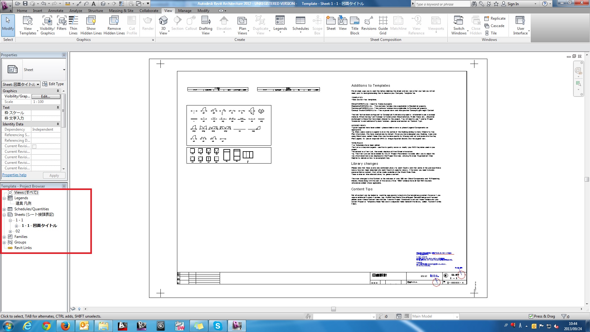

-Hi evrybody. My template don't creat Floor Plan and Level. Please help me.
Mon, Sep 23, 2013 at 11:24:15 PM | Template don't creat Floor Plan and Level
minhtu2004
Joined: Thu, Apr 4, 2013
2 Posts
-Don't have Level.

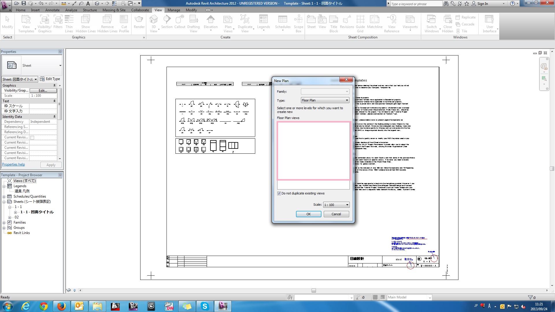

In your second image uncheck the box that sayd "Do not duplicate existing views"
