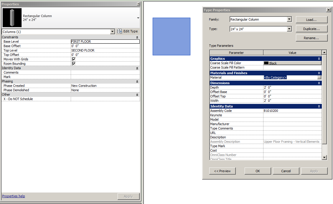

I am new to revit i am using 2013 i would like to know how i add materials to a column so it has the look of a brick pier/pillar in my project i have attatched materials but its not showing in any of my views hatched with brickwork can someone please help me thanks

Not enough information on your problem.  Do you have a hatch pattern assigned to your material?  Are you sure you have assigned a material to the column?
Mon, Sep 23, 2013 at 3:04:43 PM | Pier in brick
Architectural columns will assume the material of a wall it is placed against.  Structural columns will not.  What do you have?

I have drawn a extension which is in brick but the colomns are not attatched to the brick wall they are independant which carry a cateleiver roof i have had alot of experience with architectural dektop but im very new to revit im not sure if i have assigned the material or the hatch correctly thats what i would lke to know how to do if you have the time would be ver gratefull thanks

This is an architectural column and the materials are set in the type.

thanks for your help fixed it now i can get my plans finished this revit is so much better than adt it has some amazing capabillities thanks for your time everyone
