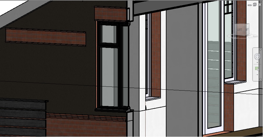

hi all,
I there is an image at all the wall openings (the brick ones at the windows and doors) that I dont want. it looks looks asthough it was was the wall sweep image but when I change the wall sweep material it still stays the same. i have attached the image.
Thanks in advance!
Mon, Sep 23, 2013 at 8:38:16 AM | WALL CUT (openings) MATERIAL
It appears that someone painted the returns at your openings.  These can be defined in the wall type.
Repaint those to default.

thx. how do I do that?
Sat, Sep 28, 2013 at 10:56:04 AM | WALL CUT (openings) MATERIAL
mneglia
Joined: Thu, Jul 7, 2011
7 Posts
If you are using version 2013 or above, you can use the "Remove Paint" tool which is located within the paint tool under the modify tab. Remove the paint from the unwanted surfaces. If you are using 2012 or older, pick the paint tool and choose the <By Catagory> material and pick the surfaces that have the unwanted paint applied. Check out my Revit blog at bimeveryday.com
I hope this helps!
