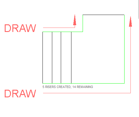

I am working on a stair that ends in a landing. I've watched multiple tutorials but I cannot get this to work. I have checked "monolithic stairs" and unchecked "end with riser." Attached is a screen shot of what I'm trying to do. I continue to get the error, "Stairs require no more than two boundaries (chains of one or more Boundary Lines). Please help!

Stairs are really tricky to sketch.  When you sketch the boundry, have the chain box set and don't end any boundry lines except at angles.
Sorry - didn't see the image.

I still do not understand your response and my landing must be a square.
Thu, Sep 19, 2013 at 10:03:48 AM | Stair Ends in Landing
Your image was so light that I initially did not see it.
When you sketch the boundry of this 'L' shape, do one side then do the other and have chain on.
BTW - Always state what Revit and what update you are using.  Monolithic stairs have been a problem in the past but updates fixed most of those issues.

Oh I forgot to post the version, I'm working in Revit Architecture 2012. I tried to do your suggestion. I put chain on, did each side starting at the stair, then put the riser line across the bottom. Still got the same error.
Thu, Sep 19, 2013 at 10:27:42 AM | Stair Ends in Landing
You don't say what update!  2012 had 2 updates and I believe one of those fixed these stairs.
What do you mean "... then put the riser line across the bottom..."
Sketch the risers then add the two sides as I have shown.  Not breaks in the straight lines - for your stair there are only two chains each with only two straight lines.

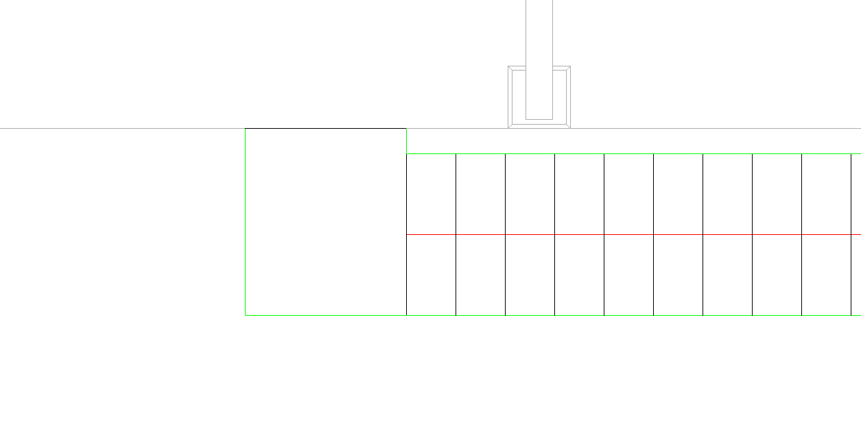

This is still not resolved for component stairs. The question remains: How do you end a component stair with a landing? Sketching a landing at the top breaks the railing. Adding a landing requires two runs. Do you have to break the component stair by converting to a sketch in order to have a landing? It's strange that this is not a check box for concluding a component stair. Please help!
