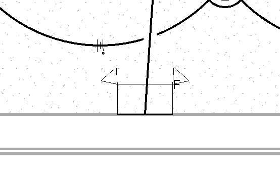

I'm working on the floor plan symbols of some electrical device families.  I want the electrical wire line to stop at the the boundary of the electrical device, not go right through it.  Can anyone show me how to do this?

Is there a connecter at the back of the device that the line is connecting to? Without seeing the actual family I would say the only way would be to edit the family.  You could also try adding a wipeout to the family since it looks like everything is showing through it, even the floor fill pattern, unless your view is set to wireframe by accident.
