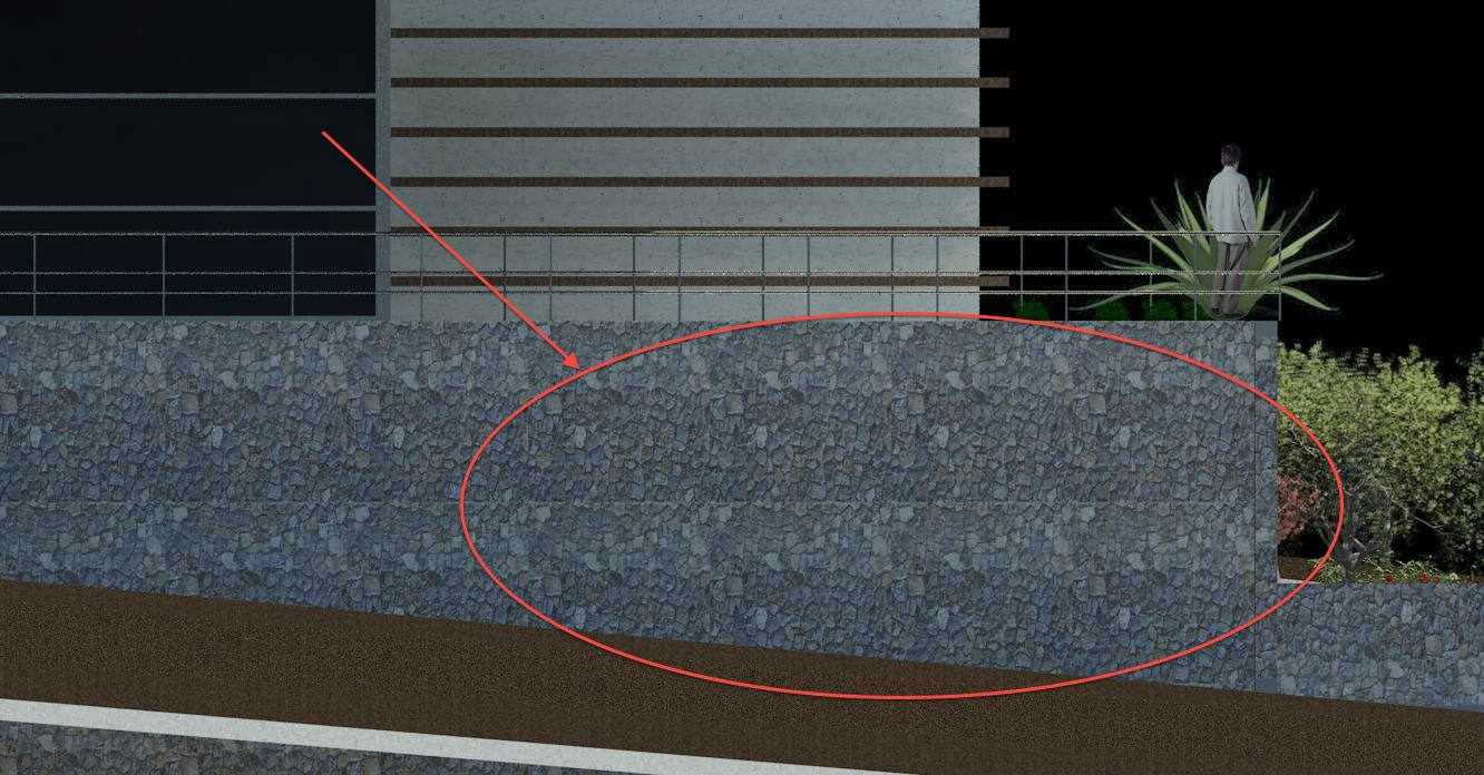

please help me! idon't know how to download new material and use in revit2012. i have tried downloading texture image from http://www.cgtextures.com/  and replace it with one of revit material library's image.but although i changed image's scale when i rendered the scene the texture was like many tiles and it was not natural.

Make the scale even bigger or change from Tiled to Stretch
