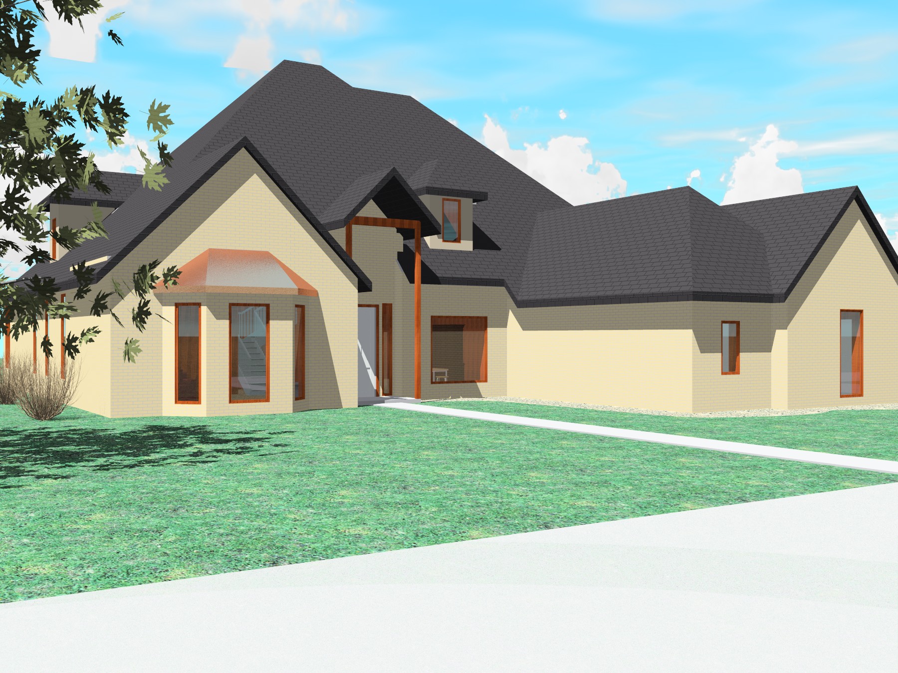

Is there a way to get the grout lines to be more apparent in these renderings, Even in the hidden line drawing, they do not appear @ this distance. Only when I move closer will the bricks and grout lines actually appear. Iv checked Display Fine, and rendering is on the highest quality. On Surface Pattern for the Visibilty Graphics there is no over-ride available. And any tips on making realistic copper? thanks

what are you using for the mortar? try a solid black for material... for the copper, I would turn off (or down) the reflections... HTH
