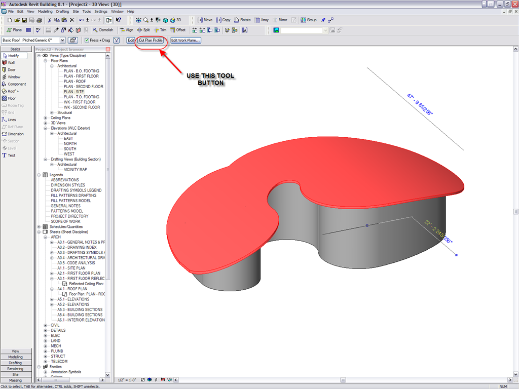

How can I put a curved roof into my drawing, I was planning on just doing a normal roof and then editing the profile but it wont let me edit the profile for roofs or for floors. Any suggestions?

Quoting broncos4life - 2006-02-13 16:12:01
"How can I put a curved roof into my drawing, I was planning on just doing a normal roof and then editing the profile but it wont let me edit the profile for roofs or for floors. Any suggestions?"
did you see "Cut Plan Profile" for extruded roofs in the Options Bar? Basically does the same as "Edit Profile" does for walls, but works for Roofs created "By Extrusion" after clicking the Roof Tool.
