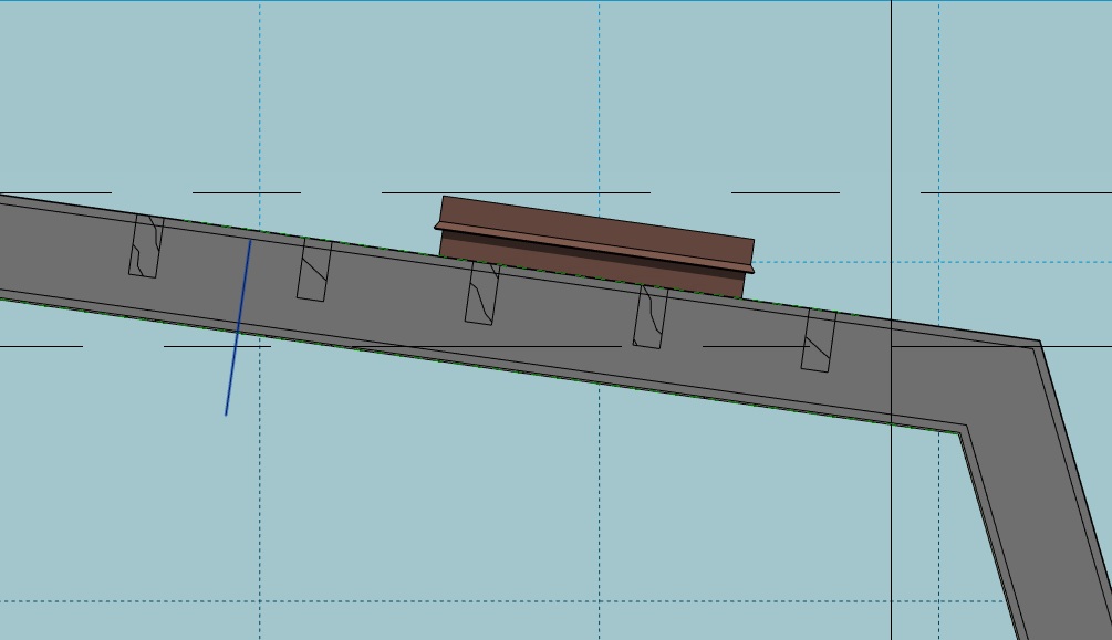

Hi, i'm new to revit and would like to know how to set layered visibility on objects or a similar feature.I'm tryn to build a roof where i have the framing into the roof and need it to display realistically in a section.The roof cut shading seems to have priority over the beam cut shading and i need those beams to stand out from the roof in shaded section view
Here's a photo
Any help pls?Thnx

You know what you mean but you have not expressed it.  My best guess - change the material color.

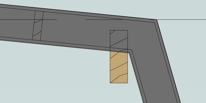

My english is not much better than my revit skills Smile.I'm tryn to just have the thing visible, autocad style, with layers.The colors are different but i don't know where visibility rules are, who has priority.I will bump into this a lot so ... the colors are different .. i attached a new pic

Typically, there are no priorities.  A solid in front of another solid will be solid and the element behind will not show through.  There are some over-rides that can be applied by category, instance, phase or filter but the default is as I initially stated.
