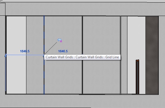

Hi all,
I am new at Revit and I have a problem with deleting the grid lines. I have unpined it and click on delete, but it's still there and won't delete. Do you all have a solution?
I attached a pic, it's how the grid line still stand after the delete key.
Thanks for your replay. Smile
Wed, Aug 28, 2013 at 10:45:17 AM | Curtain Wall Grid Lines
Your curtain wall has an automatic spacing.  I always tell my users to change the CW to a fully manual type after initial placement so that it can be modified.

So I can't change aything now?
Or I have to place a new curtain wall with manual type, so i can modifie the cw then as i want?
Wed, Aug 28, 2013 at 11:13:55 AM | Curtain Wall Grid Lines
Change the CW to a manual type....Then you can delete the grid without any problems.

yeap, select your curtain wall, in its properties there must be an option for changing the number of vertical and horizontal grid lines to a fixed number instead of a fixed distance, then you can change the number of segments in both axis

thank you all, it really helped me.
