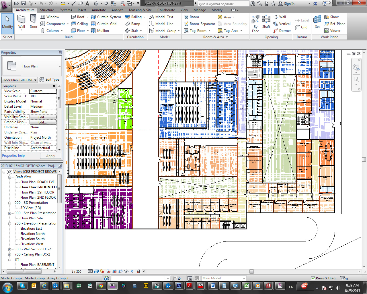

Dear Team,
Please see the attached (jpg) file showing my plan created in Revit 2013, when I apply any room color scheme I found the room color very strange and it always changes with strange white color crossing lines reflected  from the previous location of the walls or the furniture when I Pan or Zoom in/out.
 I tried to open the plan on more than 4 different computers one of them very powerful:
NIVIDIA Quadro 6000
Intel(R) Xeon(R) CPU X5687 @3.60GHz (2 processors) , 192 GB of Installed (RAM)
Did anyone suggest any solution.
Notes:
1- I did not face this problem when I work on any of 2012 Revit version files.
2- When I activate [Use Hardware Acceleration (Direct3D) ] option the strange lines disappear but the work flow becomes very slow.
3- I face this problem on any project opened on 2013 version (Small or large size project)!
Thanks & Best Regards.

My thoughts...
Do you have any imported / linked CAD objects with hatches? Try removing them.
If you check under the graphics options in Revt, do you get a notice that you are not using the correct drivers?
Try auditing the file: http://bimeveryday.com/2013/02/audit-revit-files/
