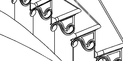

In Stair properties the nosing can run on the front and the sides.  However, it doesn't return into the side of the stairs?  Am I missing something?

Not sure what you mean.  Post an image of your problem.

Here's a shot.  If you notice the nosing as it meets the riser.  I want that profile to return to stair.  Don't tell me I have to Make a little sweep!  I actually wouldn't mind that on straight stair because it would be easy to array it but this stair is elliptical.

You can'd do that with the native stair.  Create a seperate family - face based.
